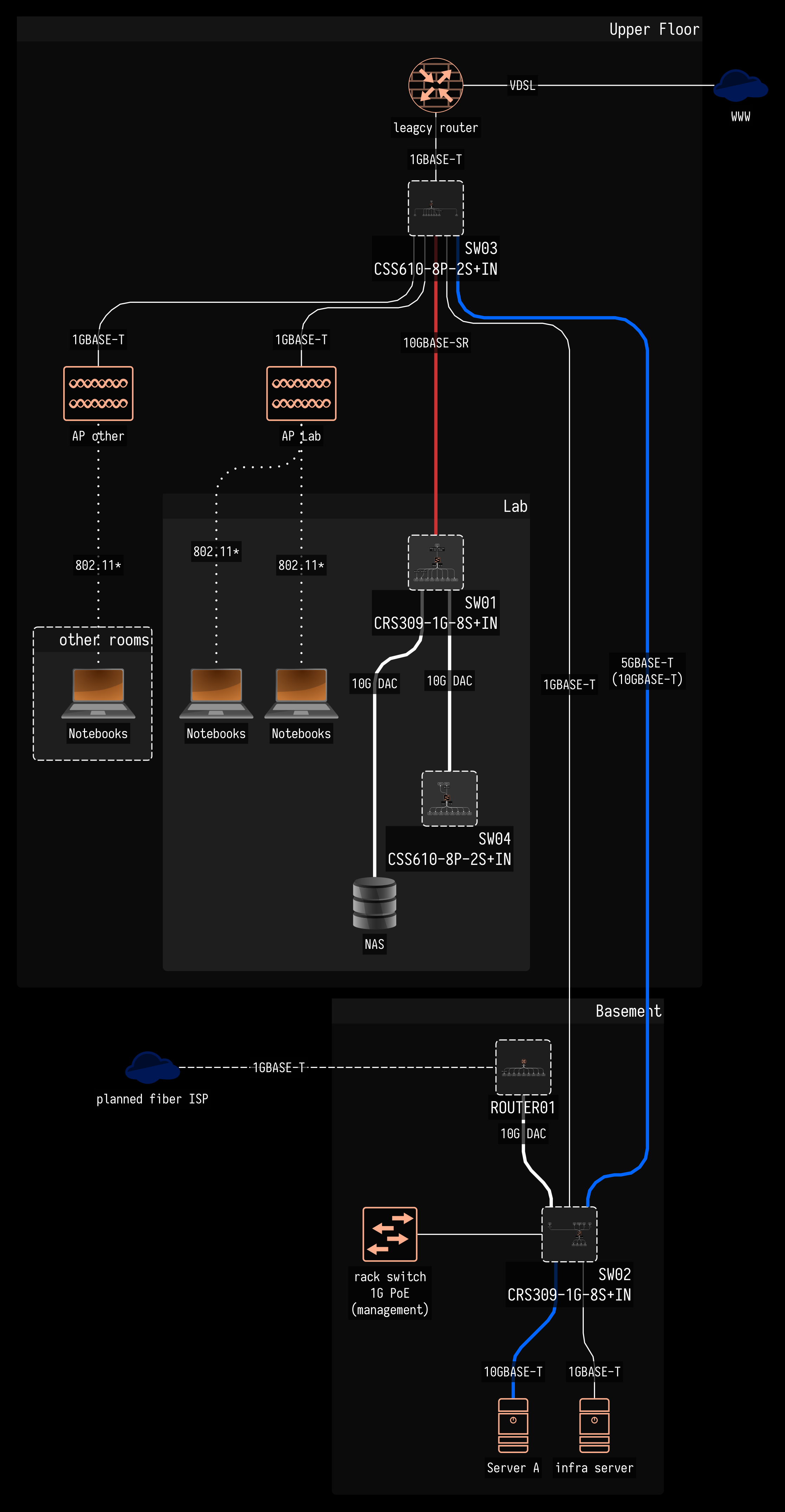

I’m the IT guy for a small company and recently moved us from a legacy flat network to the first stages of a more segregated setup. I have attached a network overview.
  • SW01 is a CRS309-1G-8S+IN, SwOS 2.13
  • SW02 is a CRS309-1G-8S+IN, SwOS 2.13
  • SW03 is a CSS610-8G-2S+IN, SwOSlite 2.17
  • (fault also occured on earlier versions, unfortunately not documented)
  • SW04 is a CSS610-8G-2S+IN, SwOSlite 2.17
  • ROUTER01 is a RB5009UG+S+IN, RouterOS 7.12
There is a VLAN overlay that I did not illustrate. Basically, every connection between switches and to the two ubiquiti APs is a trunk (mode strict, tagged only, port set to VID 4090 and not a VLAN member). The switches and access points have a management VLAN and accept connections only from there. The SSIDs are mapped to VLAN tags. ROUTER01 is where access between VLANs is routed and firewalled. The infra server hosts a few VMs, among them an openvz container for monitoring.

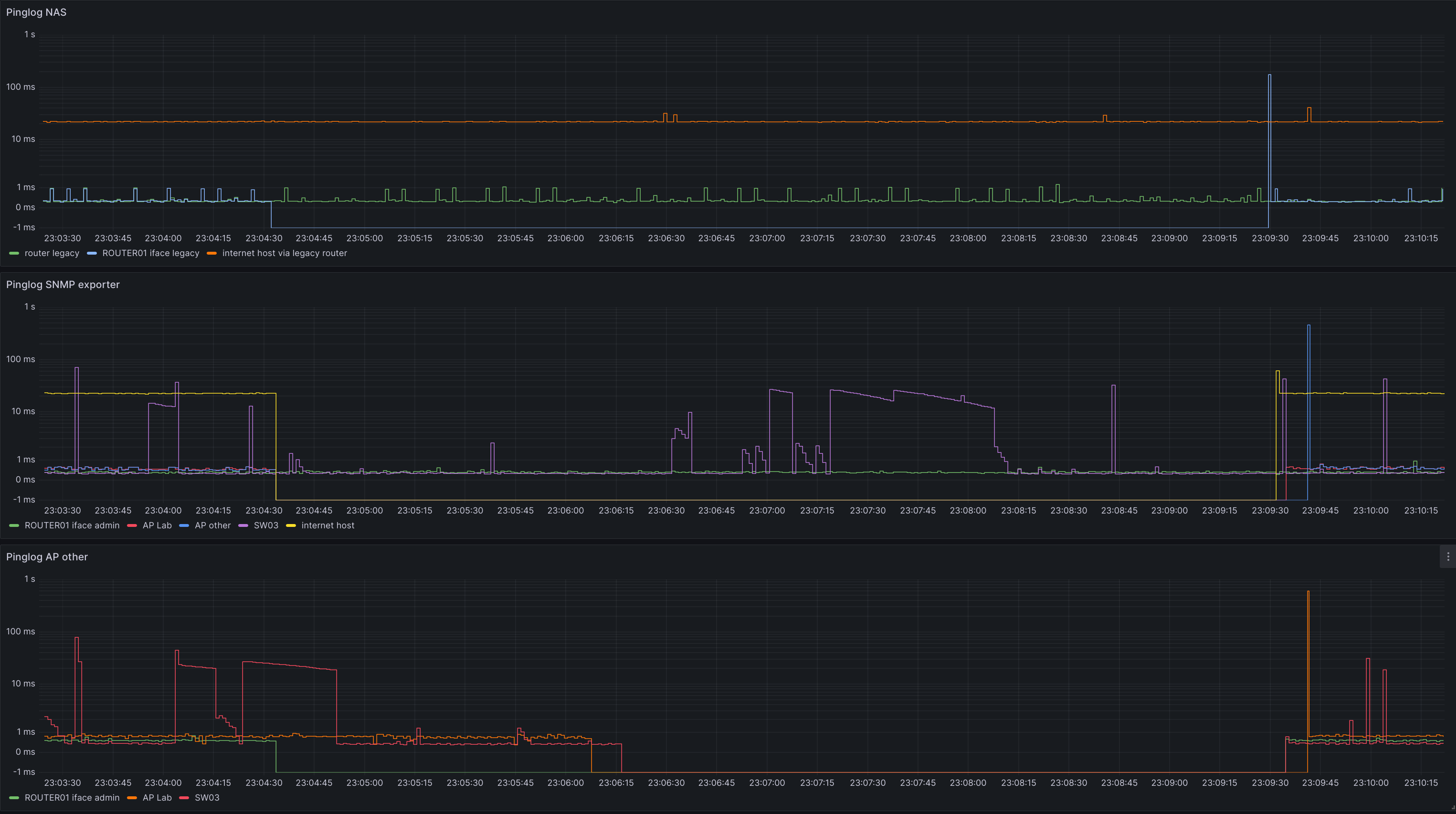

The problem manifested in random dropouts. When I wasn’t on site and could confirm quickly, I could not reproduce the issue. I then built a small tool that would periodically ping a set of IPs and log to CSV.
I deployed this tool on the openvz container already providing a prometheus SNMP exporter for the network hardware. I subsequently compiled the tool for armv7 and aarch64, so it could run on the NAS and even on the ubiquiti access points :slight_smile:
From every monitor (infra, NAS, APs), I ping various other systems, on both sides of the fault. This allowed us to identify SW03 as the culprit. All systems on the same side (nearest switch, SW01 or SW02) stay reachable with acceptable RTTs.
I periodically import the CSV data into influxdb to make it accessible via Grafana. I now have many days of data and made a few peculiar observations.

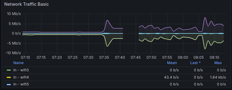

I am having a very similar problem. Same switch (CSS610-8P-2S+), simpler setup from the original author, fairly small traffic - the affected port is one (always just this one) of the 1gig ethernet ports. The port acts as a vlan trunk, on the other end of this port is a cAP ax unit. The 5-minute cut-offs happen about once a day (no obvious pattern) during which the port stops all TX (while RX counters keep incrementing). All clients on the AP (and the AP itself) are offline during the 5 minutes window.
The following gap (7:41-7:46) highlights the reachability issue of the AP on that port:

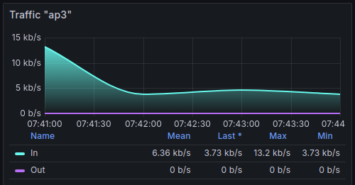

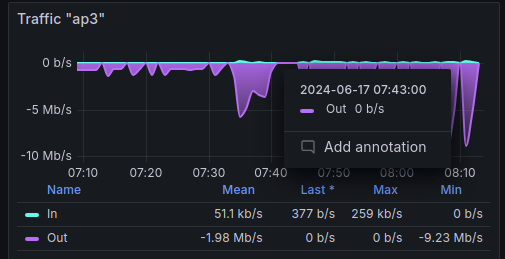

And this is the traffic on that switch port during the incident (7:41-7:46):
Detail of the switchport just during the incident window (to point out the other side is still trying to communicate):
