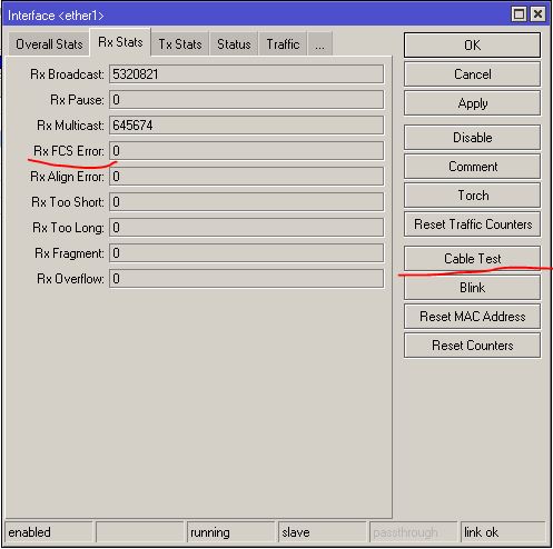

Also check for errors on the interface (Rx FCS Error) + Cable test
power adapter and poe injector was changed and it didn’t help. There’s also no log output on the other side.
After we replaced Cube there was no water inside, also it wasn’t rainy days ;D No errors on interface.
