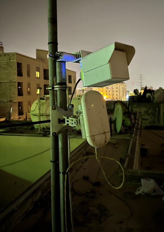

Upgrading the OLD NS5loco to Cube 60Pro Ac for the better and high throughput performance. Nice to have like this kind of cpe which is not expensive yet reliable on the performance.
Kudos to Mikrotik Team.

They work and don’t lockup like Ubiquiti 60Ghz stuff
