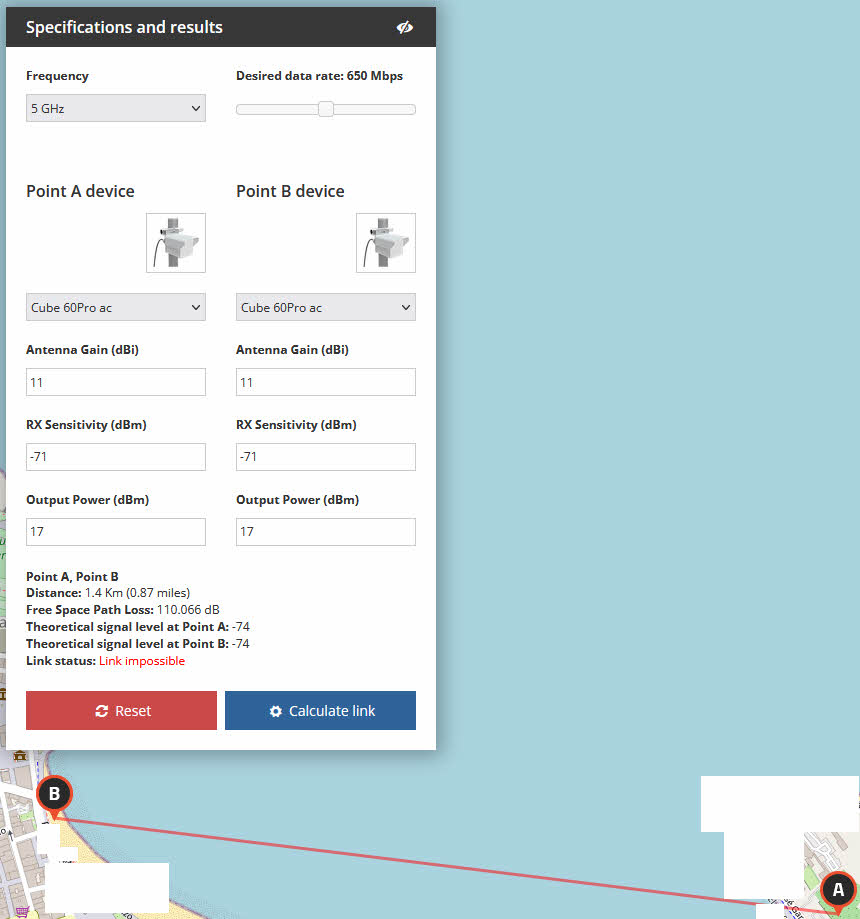

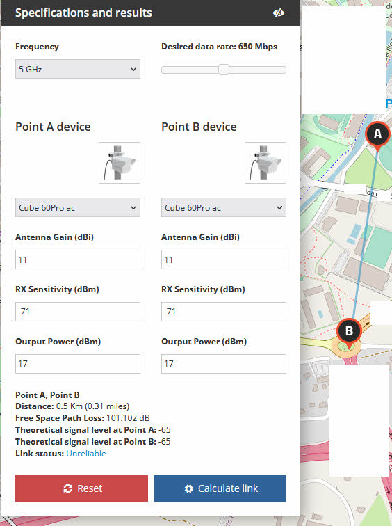

I have a pair of Mikrotik 60 PRO AC equipment (CubeG-5ac-60ay).
According to the information on the web, they can make links up to 2.4 km, however on the calculator page www.mikrotik.com/calculator any link above 300 meters shows it as impossible. Any experience with this equipment at 60GHZ and distances of 1km with direct vision?
Example1:
Example2:
The calculator is for 5GHz only (it actually says that in your images). Don’t use it for estimating 60GHz links.
So why doesn’t it remove 60GHz devices from the list when you select frequency 5GHz?
It does it the other way round.
because this model includes a small 5GHz module, for backup link purposes. Calculator uses that one for the estimate, not the main 60GHz interface.
Please adjust the calculator to calculate the 60Ghz band. Which is the main use of the Cube. Thank you
