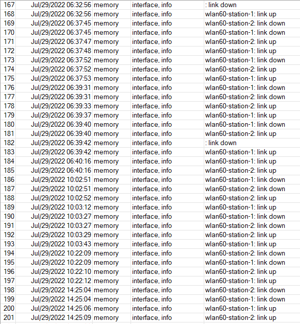

I have CubeSA 60Pro.
If I have only one clinet ( RBLHGG-60ad ), all was ok.
Now I have two client RBLHGG-60ad and CubeG-5ac60ay and sometime booth client drop and reconnect.
It seems to do it under higher load.
If I try Bandwidth test from AP to client, after some second both client drop and reconnect.
I try ROS 7.3.1 and 7.4.
Thanx for help
Just a screenshot of the logs…

AP Configuration :
add name=bridge_102 protocol-mode=none
add name=bridge_118 protocol-mode=none
/interface w60g
set [ find ] disabled=no frequency=62640 isolate-stations=no name=wlan60-1
ssid=xxxxxx
/interface vlan
add comment=10.1.137.0/24 interface=ether1 name=vlan102 vlan-id=102
add comment=“SG Havirna” interface=ether1 name=vlan118 vlan-id=118
/interface w60g station
add comment=“WB 1a ZaSokolovnou” mac-address=xxxxxx name=
wlan60-station-1 parent=wlan60-1 put-in-bridge=bridge_118 remote-address=
xxxxxx
add mac-address=xxxxxx name=wlan60-station-2 parent=wlan60-1
put-in-bridge=bridge_102 remote-address=xxxxxx
add bridge=bridge_118 interface=vlan118
add bridge=bridge_102 interface=vlan102
/ipv6 settings
/interface ovpn-server server
set auth=sha1,md5
add address=10.1.140.240/24 interface=bridge_118 network=10.1.140.0
set servers=10.1.1.201,10.1.2.201
add disabled=no dst-address=0.0.0.0/0 gateway=10.1.140.1 routing-table=main
suppress-hw-offload=no
/snmp
set enabled=yes
/system clock
set time-zone-name=Europe/Prague
/system gps
set port=gps set-system-time=no
/system ntp client
set enabled=yes
/system ntp client servers
add address=ntp.oslavany.net
/system routerboard settings
set cpu-frequency=716MHz
/tool graphing
set store-every=24hours
/tool graphing interface
add
/tool graphing resource
add
Thanx for help
I have same issue with 3 clients. Did you find a solution ?
