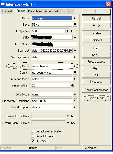

Hi, I have the following licence:
[admin@p2p] > /system license print
software-id: “ARHF-LTT”
upgradable-to: v4.x
nlevel: 4
features: extra-channels
[admin@p2p] >
I have a R52H wireless card and country=no_country_set, but /in wi info print does not show the custom frequencies! Any ideas why is that so?
You need to set the Frequency mode from Manual TX-Power to Superchannel, you will find it in the attached Pic, you just need to change the manual txpower to superchannel, hope this will help you out.
Thanks,
Hesham
