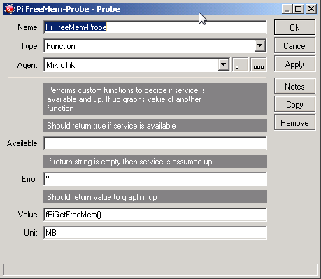

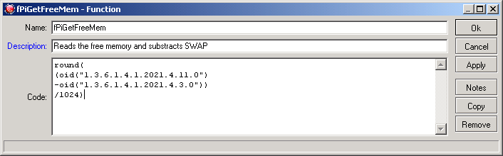

Hi there,
I created a custom probe for my raspberry pi devices, type function (see attachments).
The first strange thing was, that this probe was automatically added to all my devices, or at least every device had it somehow after a while.
Then I removed the probe from some devices that do not require it but it is being re-added once the device is going from inactive to active again.
Did I misconfigure something or is this a bug?
Thanks a lot for your time,
Christian
