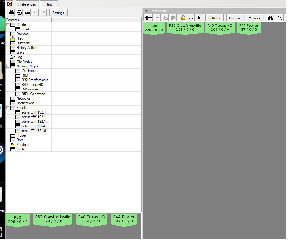

I have 5 maps - however a tech from a mikrotik convention added a 4 of maps to a dashboard (SEE dude1.png) I cant seem to figure out how he added them so i can see if all maps are green and or red/ how many are down - I have added a 5th map - and would like to figure out how to get it on the dashboard.
anyone have any thoughts? Im sure its simple, but Ihave not been able to figure it out

Mike - if you have not already figured this out: With the .Dashboard map open, Right-Click on empty space and select add sub-map. Then select the existing map that you want.
