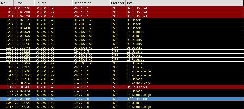

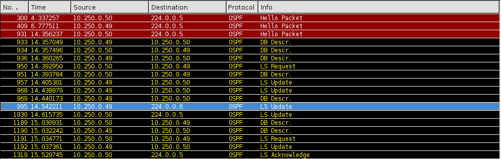

I made some investigations with wireshark. There are screenshots from the good situation (network 10.250.0.48/29 were enabled in ospf menu on both routers in almost same time) and also from bad situation. I also enclosed traffic dumps from both situations (pcap format, sorry for rsc file extensions but i couldn’t upload it to forum).
According to screenshots after few packets of database exchange router 10.250.0.49 sends multicast to DR multicast address (224.0.0.6) in good situation but it doesn’t happen in bad situation. I suppose that it has to be a bug in ospf implementation.
