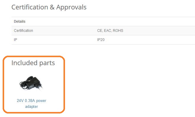

Looking at the PDF, there is one thing that worries me:
They declare this:
Max power consumption without attachments 4 W
Max power consumption 10 W
So far, so good. But the power supply sent with the device (as stated on the PDF) is one 24V 0,38A! If I’m not mistaken, it would have a limit of 9,12 W! This isn’t even enough to power the declared maximum usage.
True, it isn’t being sold yet. They may very well sell it with a 24V 0,5A power supply, and problem solved. But as of now, the matched power supply can’t power it at 100% usage.

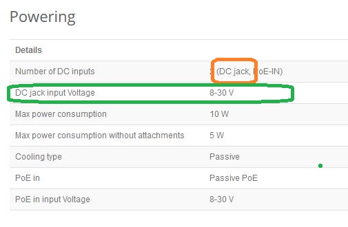

Are you that lazy?? Checking the plain old hex…
Rules of thumb:
  1. voltage (dc output of adapter) must be an exact match for device input voltage ( or within the stated range if one is provided )
  2. amperage (current) provided by adapter must be equal to or greater than expected device current input.
  3. Polarity must match: Most common is centre positive.
  4. (THANKS MKX) → Plug Diameter: 5.5mm outside and 2mm inside diameter, female, pin positive plug, accepts 8-30V DC
