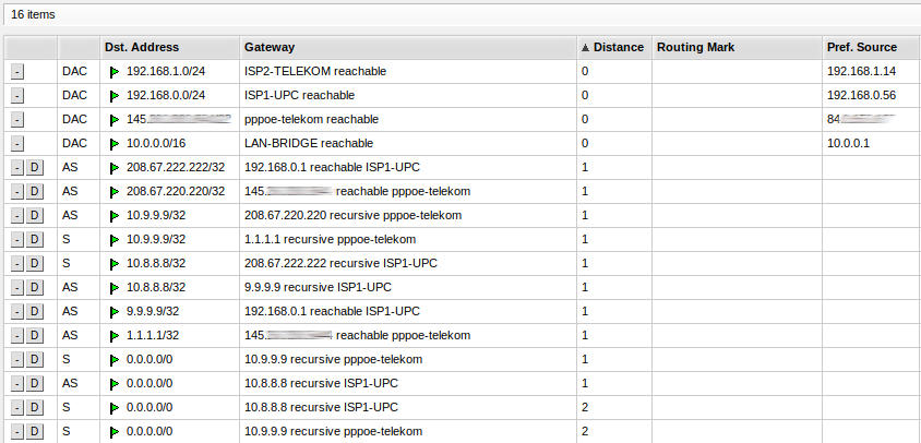

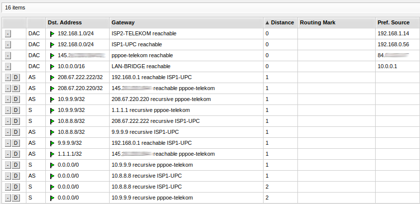

I could manage to create a working setup with virtual hops:
But If I add the routing marks (from the wiki page) it doesn’t work anymore:
Why? Should I create some firewall rules (mangle)?
