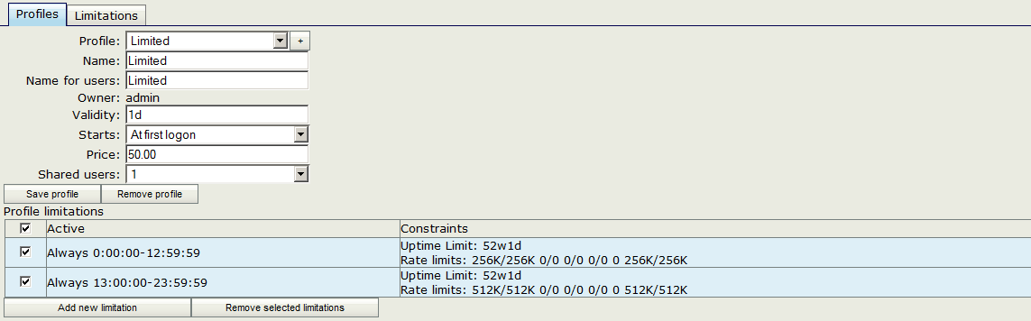

I’m using PPPoE with MkT User Manager and want to configure time based bandwidth (day/night). Here’s what I did…
  1. Created a Profile
  2. Added two limitation based on time
    a) 256k - 00:00:00 - 12:59:59
    b) 512k - 13:00:00 - 23:59:59
  3. Created an user and associated with above mentioned profile.
But it didn’t work out. I had to disconnect and then reconnect the PPPoE to get 512k. Any idea why ?
Please help. Thanks in advance.
Because the RADIUS token had already been validated. You might want to try using scheduler to script this process.
COA messages are not supported by PPPoE at MikroTik RouterOS.
Only DM messages are supported for PPPoE.
(Change on the fly is supported in HOTSPOT however)
