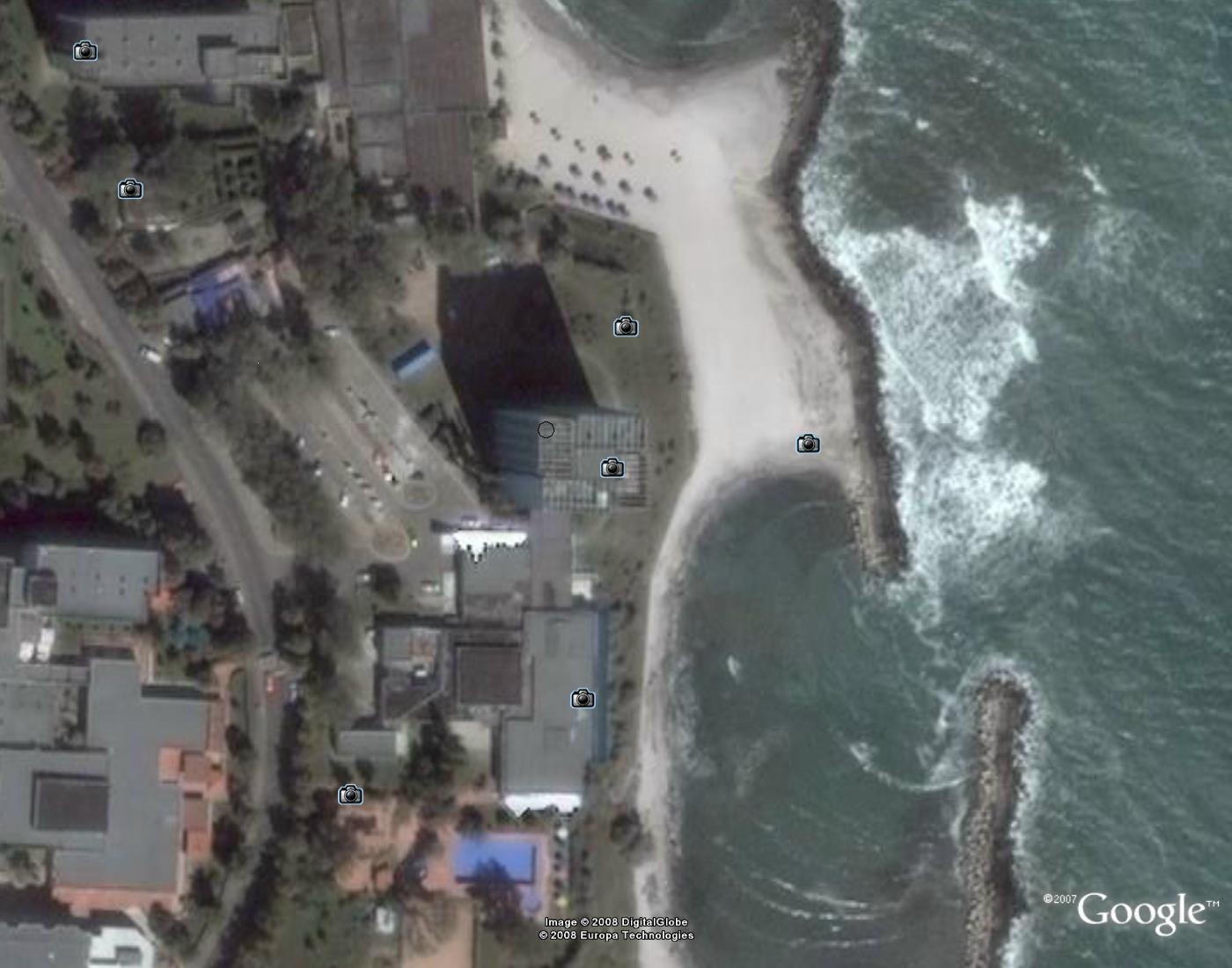

Sea in the back of the sectors.
I have another RB411 in a separate box, with 24dBi grid that is not affected and a 5.2Ghz link in another separate box that is not affected as well.
Antennas are in the black circle.
Maybe some other user is taking over 2.4GHz for their own purpose. What is your CCQ during the day? CCQ during the night?

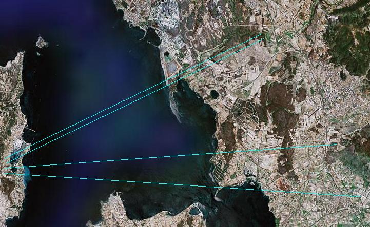

I got a similar problem with 4 links serving an island 15km of sea from the main land. I’m able to make 100%/100% CCQ links (one of them is a 35km link with an awesome CCQ).
But.. randomly those links go down. -90 signal, 30%CCQ,disconnections. Then suddendly back to normal after 20 mins…
It’s impossible there’s something between them, neither the Titanic is high enough to disturb that link.
It’s not heat related, since this happens in the middle of the night too.
Machines are all far from each others like 3 meters.
I tried to use 5ghz-10mhz but even it’s sightly better, i continue experiencing the same issues.
RB532s and RB333 - all with ROS3.10 with noise immunity. Frequency not used by anyone.
Even everything looks perfect for 20 mins (after i recalibrated everything), it mess up after a while…

Perhaps some sort of problems with the tide?
Different reflections depending on wind/tide/waves, …?
Sorry, just a guess - this CAN in theory kill your links, but I’m living several hundred kilometers away from any sea, so no first-hand experience :wink:
As the suface of the water heats up with the sun, thermal evaporation can occur which can potentially take down links over water.
In these instances you want to dipole your links.
http://en.wikipedia.org/wiki/Dipole_antenna ?
My links are not over water…water is behind.

Is that a hotel your antenna is on ?
If so, check if they are using DECT phones/ microwave ovens near the top of the tower… Might be just that.
Or, do they have a hotspot installed in ?
Must be some kind of noise out there.
when i do a scan , i found at least 10-12 ap’s :laughing: but these ap’s work in the night too…
