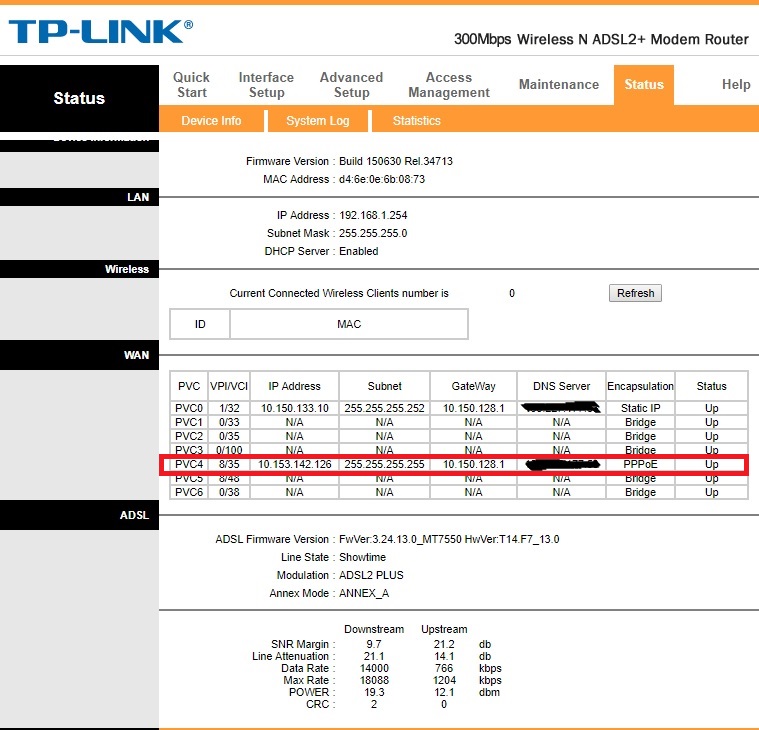

I checked my ip address on the adsl wan port and I think it is a private ip (pvc4 is the working one and its ip in range 10.0.0.0) and thus I guess I am behind a nat source from the isp.

yes true its nat
