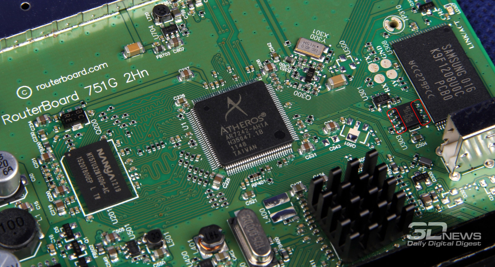

Managed to unbrick my 751G-2HnD somehow (was playing with nand/flash pins with screwdriver, noticed it can start blinking with ACT when shorting some pins on flash when RES is pressed and ACT is gonna light - 1 sec after power/reset), probably some crc calculation went wrong and router started to blink with ACT led (few times it hanged with blinking) and probably restored default config, because then I could login with Winbox. After this it started to work normally like before the incident. Pressing RES button is working again for restoring default config or netinstall (when pressing longer). But with netinstall after loading latest routeros status never went to “waiting reboot”, it just went to “Ready” again, and after manual reboot it wasn’t updated. So I don’t know if netinstall is working for me, updated it in normal way.

Can’t do tutorial because I’m not sure what exactly I did and what actions exactly made it alive again, but here are some points:
  1. Hold reset button all the time (maybe you can use reset pad for this, but it’s hard to short it with anything except soldering, so I was just holding reset button).
  2. When you connect power (and reset button is hold), ACT button should start lighting after 1-2 sec. Try to short some pins for a short time exactly at that time when ACT is going to be lit.
  3. I was shortening pins with a thin thing, so probably only one pair was shorten at the same time.
  4. Once or twice I was able to make ACT button start blinking (but it continued blinking forever, so no luck was at that time). Basically this blinking made me curious and wanted to continue.
  5. Instead of removing and reconnecting the power cord (it can be annoying when doing this again and again) you can try to short some pins (don’t remember which exactly) for a short time and router will reset.
  6. Probably you want to connect router’s 1st port to your PC to monitor traffic (I used wireshark) and see when it become alive again (in netinstall mode). But in my case it was like it just restored its original configuration, blinked with all port leds and start working.
  7. Attached image of the flash I was playing with.
