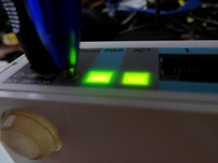

Rb750 after upgrade from 3.28 to 5.16 is dead.
Not booting, no link activity on ethernet ports.
Power and ACTivity LED is still ON after power on
Hold this button during boot time longer, until LED turns off,
then release it to make RB750 look for Netinstall servers.
Holding this button , but LED is still ON. Not able to use Netinstall :frowning:
RB is out of waranty. The attempted upgrade and I lost him? :frowning:
Any chance of recovery or RB750 to trash?

Try to reset using “reset hole”: http://wiki.mikrotik.com/wiki/Manual:Password_reset
This will reset bootloader and then try Netinstall again.
Unfortunately it does not help. :frowning:
There seems to be damaged RouterBOOT. But with version 3.28 worked. Probably damaged during the upgrade… :frowning:

We received four used RB750s a couple days ago. All four booted fine and functioned properly running 4.x, so I began the process of upgrading (to 4.17, 5.0, then 5.21, updating the firmware whenever one becomes available). Three out of four made it to ROS 5.21 & 3.0 firmware; one got bricked along the way exactly as described in this thread. After uploading a new ROS version and upgrading the firmware, the reboot simply never completed. All LEDs came on as expected, but never went out. All components on the board look fine, no smoke found its way out of the circuitry. No amount of playing with the reset button or shorting the reset pad has any effect.
Now what: throw it away because of some boot loader mismatch/glitch?!
