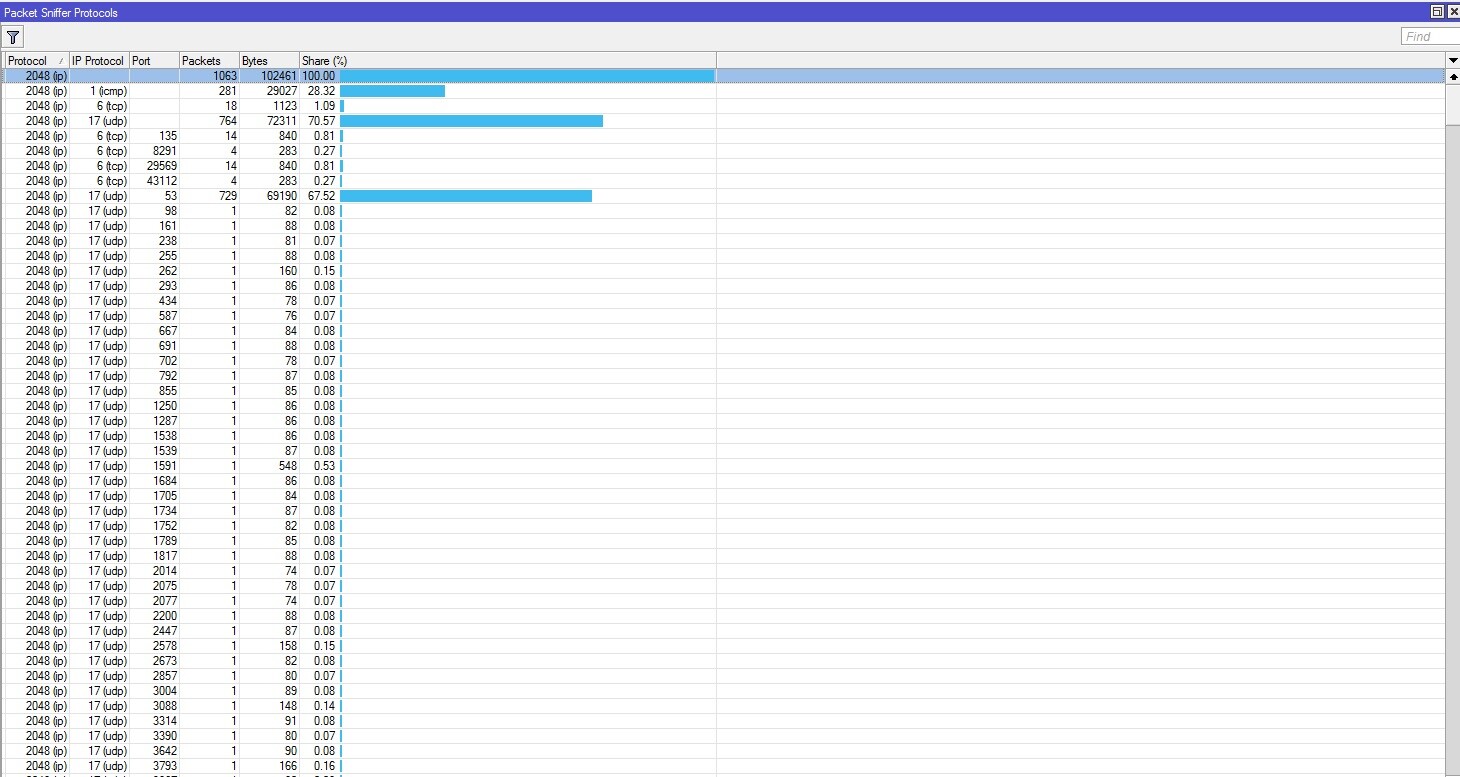

I have a problem on one of my Mikrotiks and I am having some issues figuring out a set of rules that will allow incoming OpenVPN connections get to a server behind the router and accept PPTP/L2TP connections on the router itself while still dropping DDoS traffic.
There are three things I am seeing ICMP, DNS Amplification, non proper DNS Amplification. Non proper meaning wrong ports instead of coming from source port 53 its coming from any port from about 10k to 60k. 2/3rds of it is a dns attack 1/3rd of it is ICMP and the stragglers are non standard port dns attacks. Here is a glimpse of the traffic from my packet sniffer. This is from just 2 seconds of captures.
I have tried the rules on the wiki but it blocks PPTP/L2TP and OpenVPN traffic as well. Hope someone cal help.
How about accepting connections to the udp ports you know are being used for openvpn, accepting “established” packets, accepting connections to udp/1701 (l2tp) and dropping the rest of udp? there’s not much you can do with icmp, except drop it or use a limiter in firewall so only a certain amount of icmp gets past. According to the traffic signature, you won’t have to police gre and/or tcp, so pptp should be fine. Note that both limiting and using “established” connection state will need conntrack to be on.
Yea that is basically what I am doing now. My problem is users that are assigned public IP addresses can have incoming traffic to their IP. Now anything above UDP 1024 is going to be dropped due to the firewall rule.
That shouldn’t be a big problem, not a lot of services use these ports server-side anyway, most of them multimedia- or gaming-related. If customers are complaining, you can justify this measure with an incoming ddos, they should understand that issue.
Very true. I had hoped to find something I could add to the other routers but maybe I wont be able to be proactive about it. This ddos has been going on for a week now. Hopefully it will let up soon.
