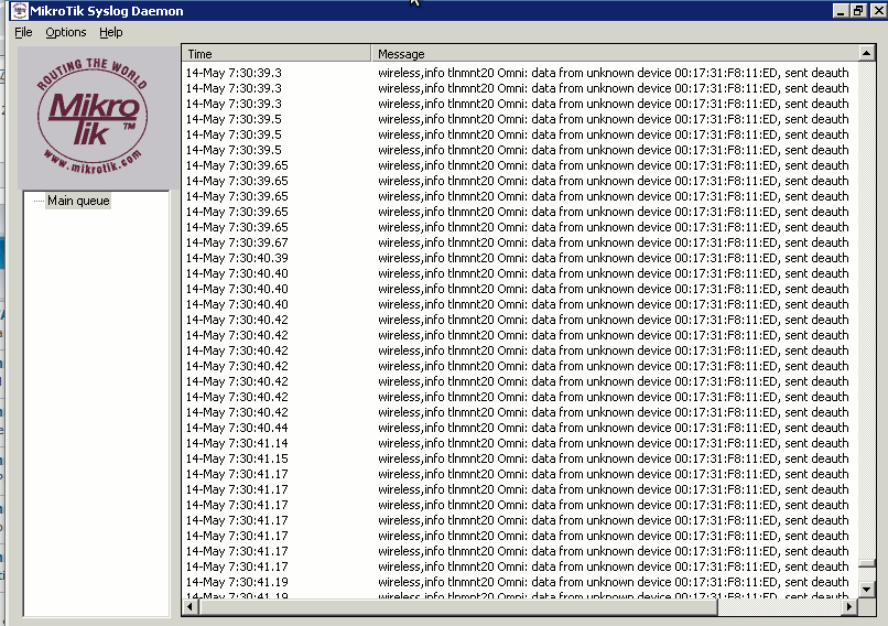

Some time ago we noticed that strange things are happening on many wireless AP-s we have. Affected are only 2.4Ghz. The mac adress (see picture) periodically changes, also we do not have customers with such mac addresses. Tried to disable default auth and forwarding on the wireless device, permitting only mac-s we trust - but the same thing is going on. As we suspect ddos attack against us from our competitor, before going to police we want to ask an advice from You.
What is excatly going on ?
Thank you

They are injecting packets in your network.
You can avoid this using wpa keys. : /
You can try to use management frame protection which is used against ‘Deauthentication attack prevention, MAC address cloning issues.’
Try this link from the wiki manual- http://wiki.mikrotik.com/wiki/Manual:Interface/Wireless#Management_frame_protection

It could be an ‘attack’ or simply an idiot with a Backtrack CD or similar WEP cracking tool.
They do not care at all if it causes you any problem. They just want free internet.
I agree with Iber : you should use a better security system, such as WPA2-AES.
That is your only defence really.
… alternatively, you can do what i do, and put up WEP ‘protected’ SSIDs with a HotSpot behind them.
The ‘attacker’ then spends time cracking the simple WEP key and then gets the HotSpot, with an option to Pay.

I see this all the time on our AP’s with customers signals too low to connect.
It is more likely as wispwest suggests - i.e. low signal or a lot of interference on the channel.
The log shows only a few deauths a second, like less than 3.
A proper deauth attack would be a lot more aggressive.
Packet injection to crack WEP would also shove a lot more than a couple of packets a second at your AP, unless the attacker is a very long way away.
Well, my version of AirCrack does …
