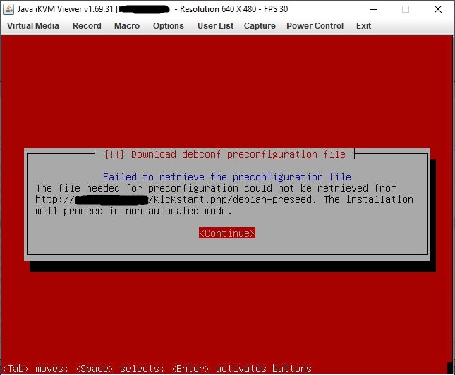

I’m testing switching functionality on CRS354 and see that they work fine for basic TOR switch. If i try to do automatic debian installation with preseed it fail for the error you can see in attached image. If i move the cable to a Cisco or FS switch it works fine. I’m experiencing this issue only with Debian and Mikrotik, it work fine if i will try to install CentOS or Windows.
During the installation i see the interface bringing up, server boot on pxe and TFTP fine and installation start. During link discover, i see link going down (on winbox i see port switch from RS to S statem then after 5 seconds came back to RS) and then up after 5 seconds. Debian see the port down and installation fails.. If i press “Continue” button, the installation will continue and end successfully.
Do someone else experienced this and know how to fix? RSTP is enabled on bridge
