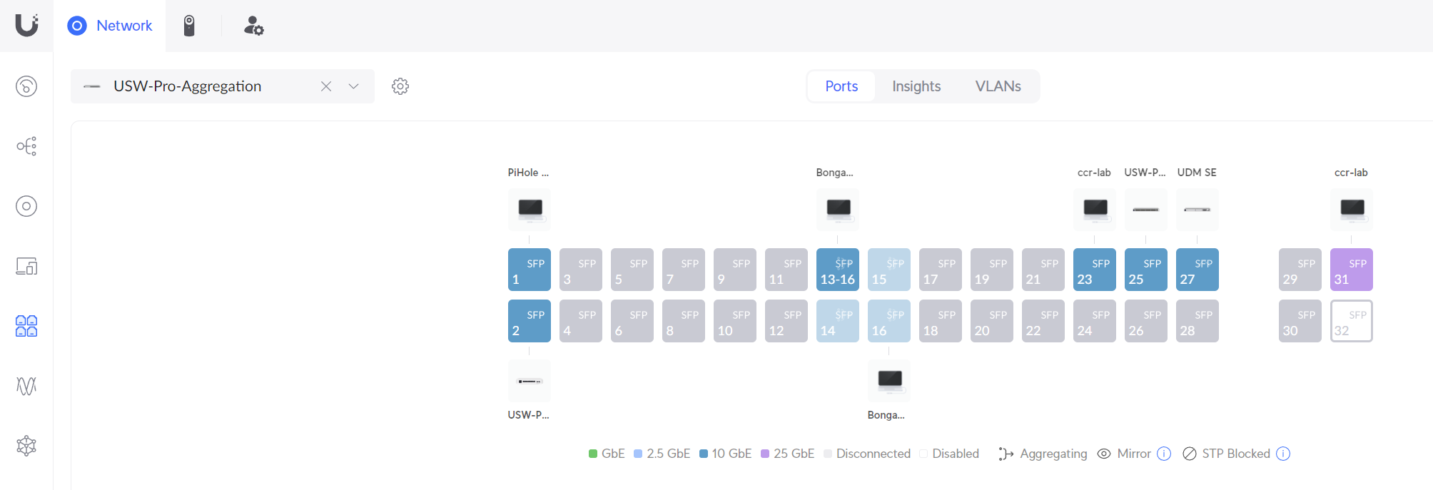

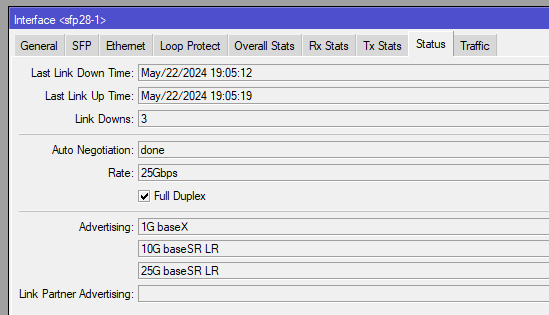

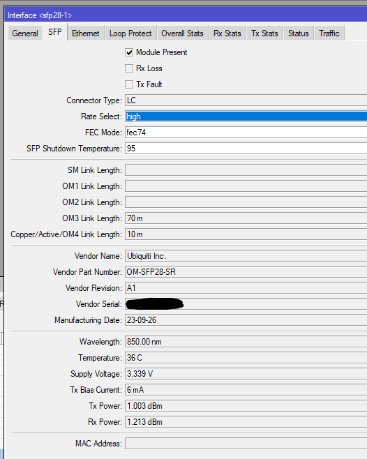

I have an Ubiquiti USW-Pro-Aggregation switch, with 28x 10Gbps SFP+ and 4x SFP28 ports hooked up to Mikrotik CCR2216-1G-12XS-2XQ
Both ends have Ubiquiti OM-SFP28-SR transceivers with MM LC Duplex cable
I changed the FEC Mode to fec74 and the link is now ok
Auto negotiate on both ends, Unifi Network and Mikrotik RouterOS
