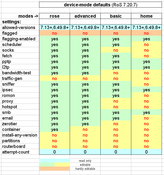

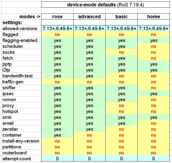

Only as a visually more immediate complement to post #12:
Just altered some second before your post for align to 7.20.7 (no change from 7.19) the post to remove "flagged" and "attempt-count" that are out of context, and moved allowed-version under "install-any-version"...
I can make them another colour, but removing them from the list would make a difference between what the user sees when issueing /system/device-mode/print Device-mode - RouterOS - MikroTik Documentation
and the coloured table.
@Amm0
So one colour (lght blue) for read-only items.
Two colours (light green and light yellow) for settable items.
Another colour (light orange) for settable (but hard to set) item(s)?
Yes, they are there, but they cannot be set...
for example attempt-count is NOT settable, but indicates the number of attempts made, so it is out of context from the list of what can be enabled or disabled...
@jaclaz you going to need another color :wink:
You can set flagged=no but only if it got flagged (and flagging-enabled=yes)
To exit the flagged state, you must perform the command "/system/device-mode/update flagged=no"
And in same sense, allowed-versions is read only, but highly useful information.
Updated table.
This way the items are the same as the output of /system/device-mode/print
and it is clear what can be changed.
If you want me to picky, group the "special ones" together so you can see the list of actual device-mode more clear.
If we're follow from doc's table and including the read-only. There is also @rextended "special", activation-timeout=5m, and we know does have a default, so if we're showing all attributes (with styling), might as well actually show all attributes.
also "authorized-public-key-hash"
but there are the values that each mode set,
and activation-timeout, flagged and authorized-public-key-hash are not set on device-mode-change...
The idea is to understand what changes if I change the mode,
not all the possible values ​​that can be changed by ignoring the mode...
A typical user (not so typical, one of the few users that actually reads the docs) would run in terminal:
and the table should (IMHO) reflect exactly that output, everything else would only (IMNSHO) confuse the matter.
I restored the original version of the post.
I was more commenting on @jaclaz graphics, than the print.
Only thought was as a "device-mode quick reference", having a few extra line highlighted in wierd colors isn't going to hurt. And gives someone less familiar a clue they might want to look at the doc if they didn't understand the colors :wink:
Except allowed-versions, and attempt-count any field, flagged included, can be changed, not "hardly editable" :wink:
