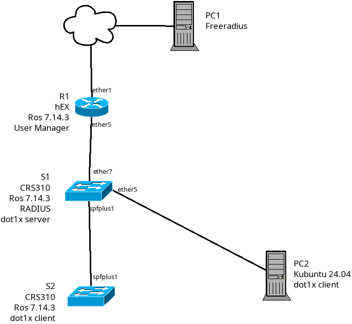

OK, I restarted from scratch.
My setup (topology see the image) :
PC1
Freeradius 3.0
user :
  • user2 with password
R1 (default configuration)
  • Usermanager
    enabled authentication port (and accounting port)
    added client (NAS in radius-speach) with ip-address and secret.
    2 users :
  • user1, with password
  • user2, with same password as on Freeradius
    both in “user group” “default”
S1 (default configuration)
  • 2 RADIUS entries :
  • IP-address pointing to R1 with corresponding secret
  • IP-address pointing to freeradius-server with corresponding secret (disabled)
  • Dot1X server
  • ethers 1 to 6 and spfplus1 as dot1x (via an interface list).
  • Auth.Types : dot1x checked
  • Retrans. Timeout : 5sec.
S2 (default configuration)
  • Dot1X client
    Interface : sfpplus1
    EAP Methods : EAP MSCHAPv2
    identity : user1
    password :
    Anon. Identity : anonymous
PC2 : Kubuntu 24.04LTS with NetworkManager
not connected to the network
