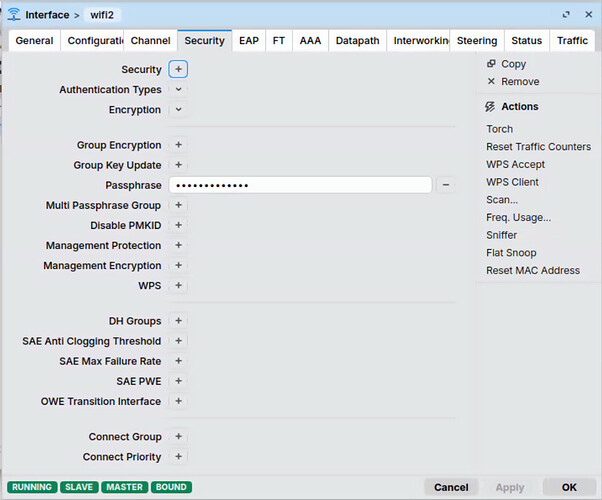

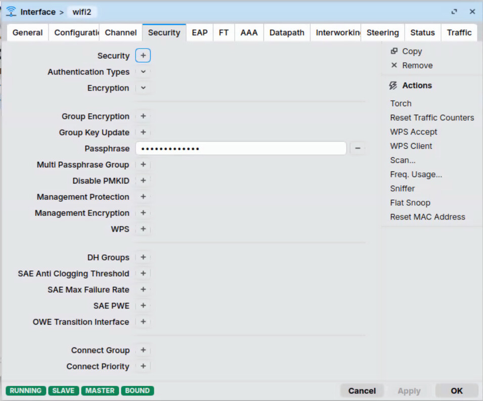

I setup a new hAP ax2 router and used the quickset function to enable the wifi radios, and i just setup the wireless key. Now looking at the security settings, there is no information about what is actually enabled with the default settings. If i click on the authentication types all the checkboxes come up empty, but i see that wpa psk is one of the options... I wonder what is the actual default auth types enabled in the router if nothing in there is actually selected?

How can i actually verify this? The whole point here is making sure WPA is not enabled...

Yes I would use a wifi scanner, the problem is I am managing this router remotely for an office, and using an external scanner is not an option. There may be a way to pull the report of what is being used in the router's terminal.
I tried:
/interface/wifi/print detail
it only shows the SSID, MAC, wifi key and a few other bits but nothing about auth types and encryption.
/interface/wifi/print proplist=name,security
lists the available wifi interfaces with no details.

Thank you for trying.. but no, the first command shows the same as i posted before with /interface/wifi/print detail, and the second one just shows the model and serial number.
