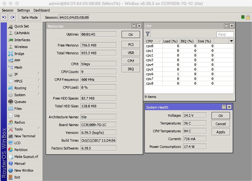

I just received my CCR1009-7G-1C-PC this evening. In the process of trying to set it up, it has rebooted several times due to too high cpu temp. Has anyone seen this, or is this CCR defective? Note that it is not 36C in my home, it is currently 20C in my home. The CCR is sitting on a cool tile floor and is barely warm to the touch.
Badly mounted heatsink?
Something was bad with that hardware. I returned it and received the replacement yesterday. The replacement is running at 50C so all is good.
