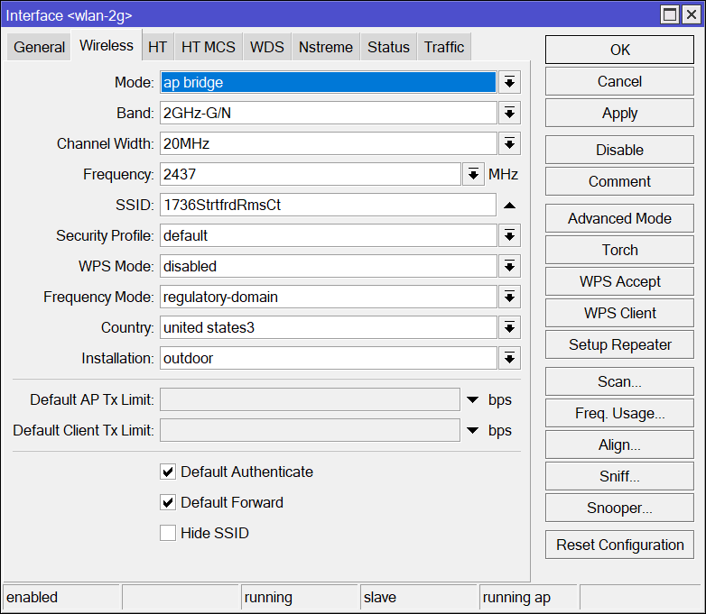

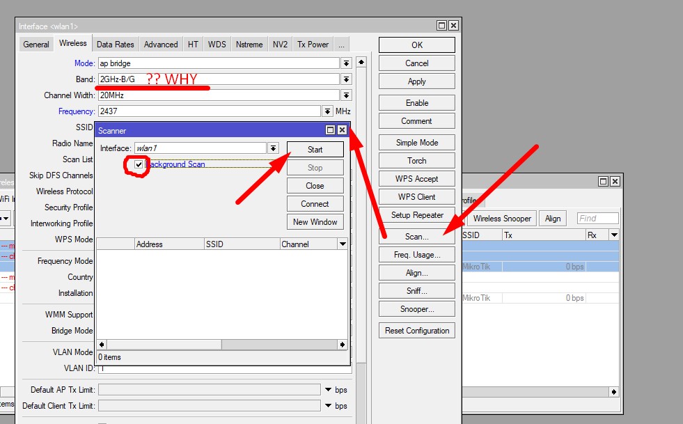

I’m not familiar with all the tools related to wifi. I did use the Freq scan to select the channels for my two existing APs: an Audience (channel 1) and an wAP AC (channel 6) on the Patio. Here are snapshots of the freq, & reg dialogs for each. I do need to go ahead and run the cable and install the cAP XL-I just want to understand why performance has degraded so badly. It is now almost impossible to use. I had to use my phone’s hotspot last night because it felt like someone resurrected my old 300 baud modem from ages ago. For months my current setup worked flawlessly, performance has been much better than I’d hoped. Zero problems with coverage. Then it tanked, and I don’t know how to figure out what happened.
Audience
wAP AC
Are you using WifiWave2 on the Audience?

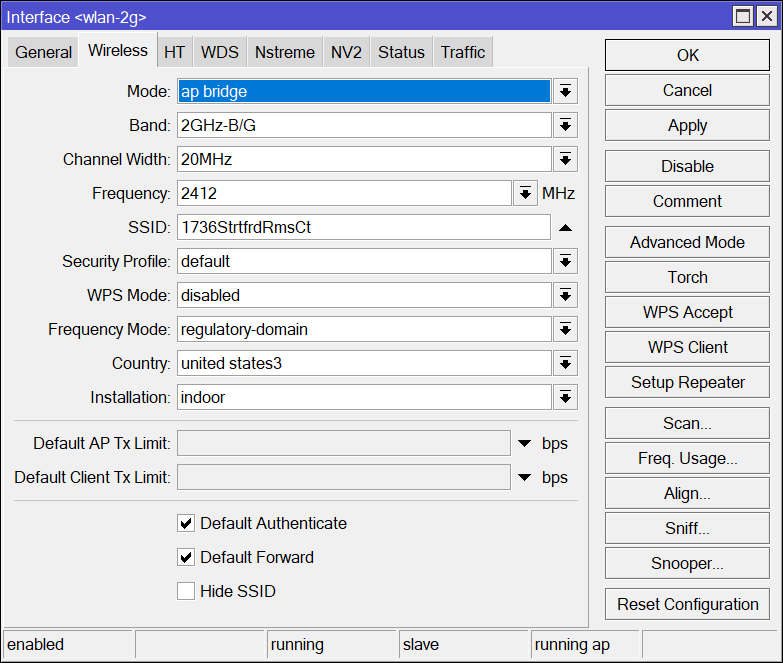

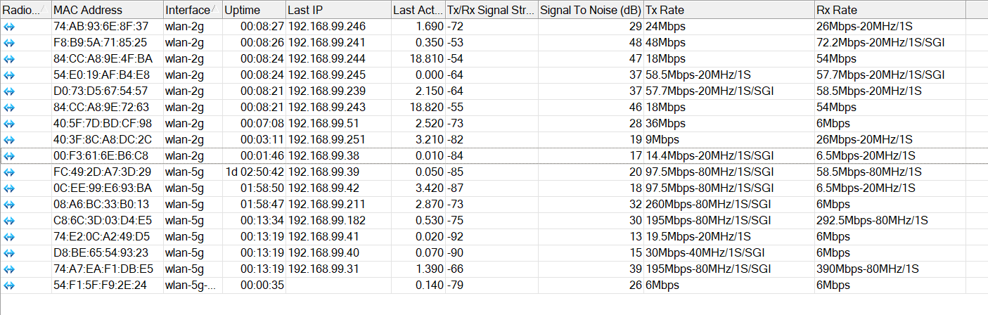

Why did you limit an interface with 13 registered clients to a useful speed of about 15-20 mbit/s? Whereas in the standard n can be 180-200 mbit/s. I think this is the main reason
The screenshot shows how to enable the air scanner.
On WiFi in the standard n is considered the boundary of a good signal level of -67 dB, values up to -75 satisfactory all that below -80 dB is considered unacceptable. You have a lot of devices connected to WAPac with very bad signal levels. This is either a sign that you are in the wrong place or that you need to add another device. The lower the signal strength the lower the connection speed, and the speed drops on all devices connected to that AP.
That’s a great question. A better question is why I didn’t see that. I would say maybe fumble fingers bumped it while browsing around, but the same thing happened on 5Ghz radio: It’s set to 5Ghz A. I have no idea how those were reset to the lowest option. I “know” I set them when I setup the AP. The patio AP is setup correctly. Embarrassed I didn’t see that before posting. I’ve looked at that dialog a dozen times the last few days. I’ll have to spend a little time with it to see if that straightens it out.
That highlights another issue. Ideally, only a couple of those devices should be on that AP. It’s pointed outside over the backyard and at the shop and those devices in the shop will have bad signal. I plan to put a wireless wire to fix that and the wAP should ideally only capture my phone or tablet when out in the backyard or on the patio. But as is it is currently grabbing a lot of devices from inside the house that used to be connected, without issue, to the Audience. It’s one of the reasons I’ve got this cAP XL sitting on my desk. I probably need a couple of them. The wAP is sitting very close to 4 iot devices that are in the house, through brick wall. Even with installing a couple cAPs, I’m not sure those cAPs will capture those devices. I may need to configure Access List to kick them off because they are currently connected to the wAP but not reachable.

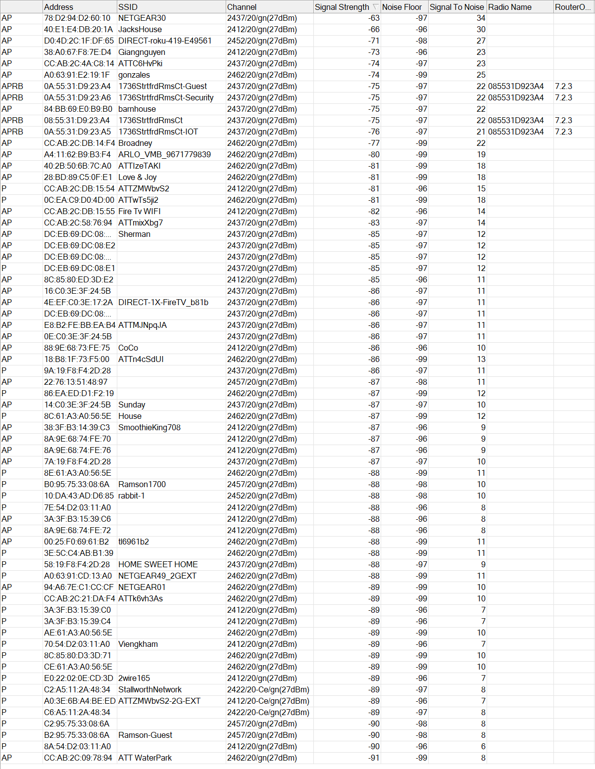

Here’s that scan on the Audience (2GHz). Had no idea there would be that many devices around the neighborhood that would be in range.
And 5GHz

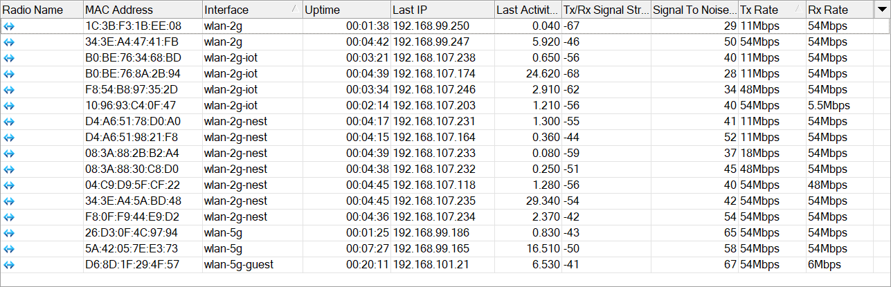

Definitely still broke.
Speed Test on wired desktop: 357.6 Down 79.9 Up
Speed Test on wireless iPad: 0.19 Down 28.5 Up
Why is it primarily affecting Down speed?
Edit: scratch that. After multiple runs it is variously affecting up/down/both. Inconsistent but still abysmal down.
EDIT 2: OK. I think I touched on the problem above. My two APs are interfering with each other. I cut off the radios on the patio AP and now things are back to normal. I didn’t think that was supposed to happen, but then I obviously don’t know much about wifi. And why did this just start? I’ve had both APs active for a while and it wasn’t a problem. What am I doing wrong there? How do I get them to play nicely?
In the Family Room where I’m testing, where the problems are most noticeable, I’m getting -55 dBm on 2.4 GHz on the Audience, -75 dBm on 5 GHz. Since cutting the radios on the wAP AC, speed has been great on the Audience, back to normal. However, I occasionally lose wifi momentarily. Maybe it’s jumping between 2.4 & 5? Not sure how to verify? Why would it do that? What can I do to make all these radios work together? Is it going to be worse when I add more APs? I didn’t realize it was so difficult to get APs to work together.
I’m now fairly confident that the wAP & Audience are interfering with each other causing the degraded performance. How do I fix that? If my device is jumping between 2.4 & 5, dropping the connection momentarily, how do I stop that?

OK. This is my plan today. So far… this plan is failing at step 1. Your point:
mmm, may have some merit. For the moment.
Okwy, not exactly failed at step 1, but my experience is contrary to the docs (https://help.mikrotik.com/docs/pages/viewpage.action?pageId=1409149#APController(CAPsMAN)-SimplesetupofaCAPsMANsystem) and to any of the tutorials I’ve watched on YT or Wireless Engineer course on Udemy. I set the most basic config on the manager (RB5009), and on the client I go to Wireless → WiFi Interfaces → CAP, and set Enabled, Interfaces to W1 & W2, Discovery Interfaces to ether1, and then … nothing. It does not auto discover the manager. Setting the DHCP caps-manager option on the manager also seems to do nothing. Only when I give the CAPsMAN Address on the clients (both audience and wapac) do they find the manager. It’s working, by manually specifying the capsman address on every client, but it bothers me when it doesn’t work as documented. What would prevent auto discovery? (apologies for the wall of code below)
