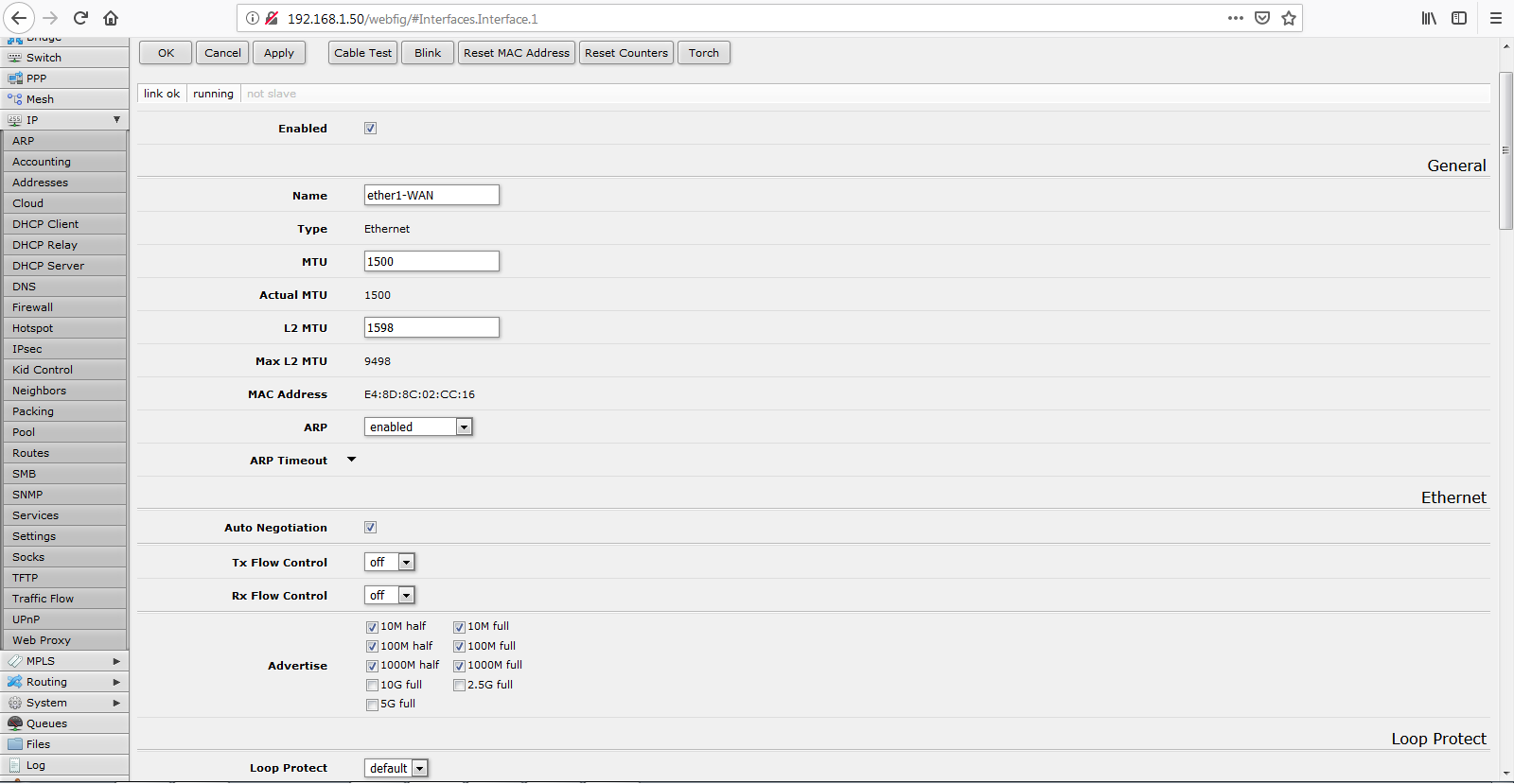

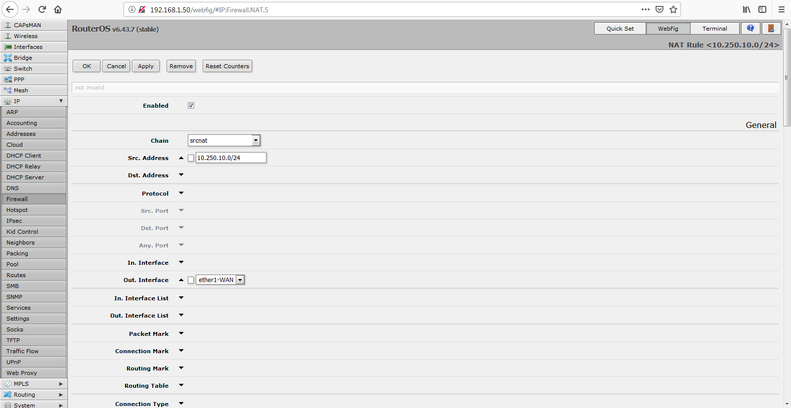

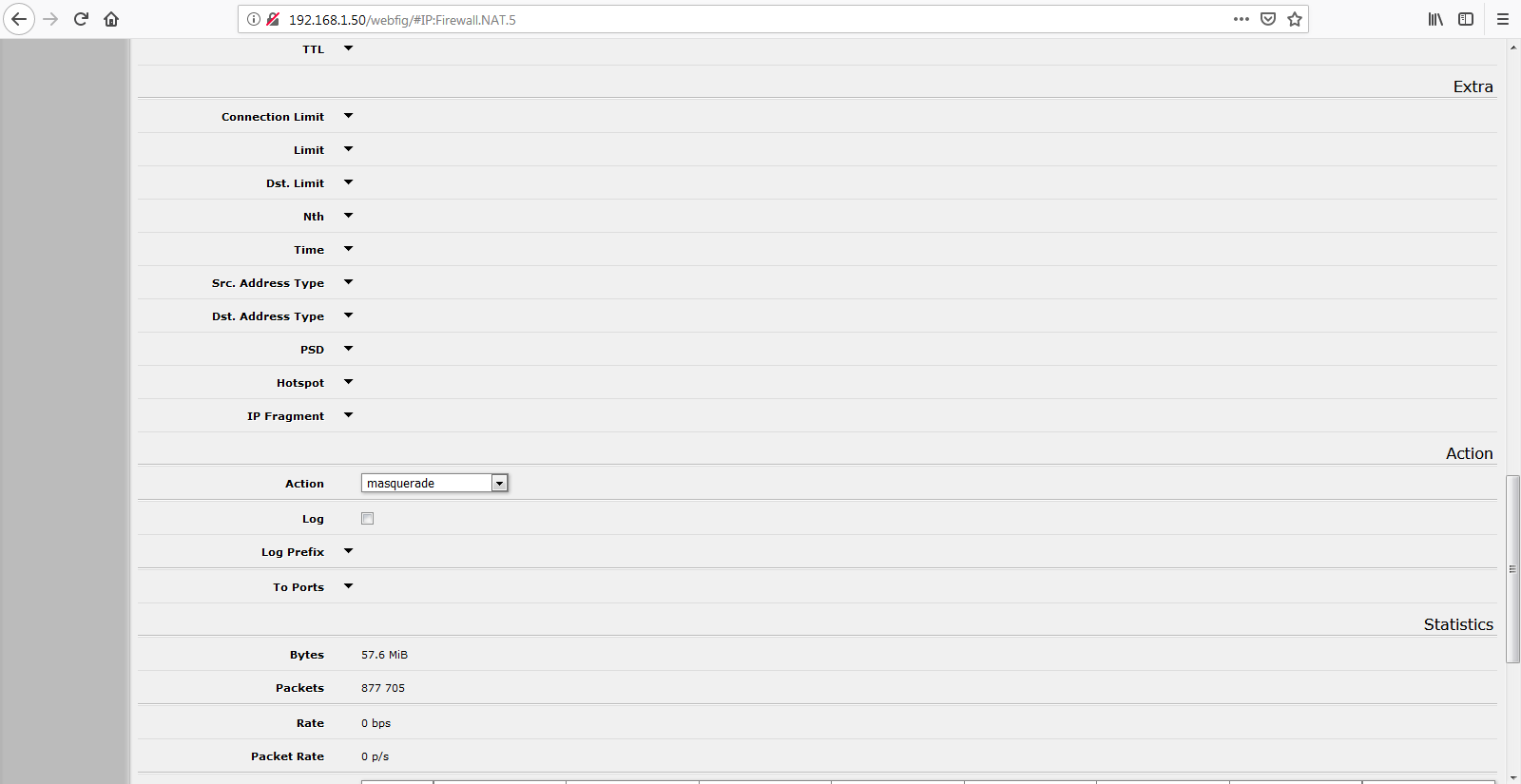

I have a Firewall / Router Mikrotik RouterBoard 1100x2 AH as the edge of my internal network. I followed tutorials to grant Internet through NAT to the internal network, it works but the network works very very slowly, you can not work with it.
I have analyzed the case for a long time, I did several tests and it seems that the cause of the slowness is packet loss more than speed.

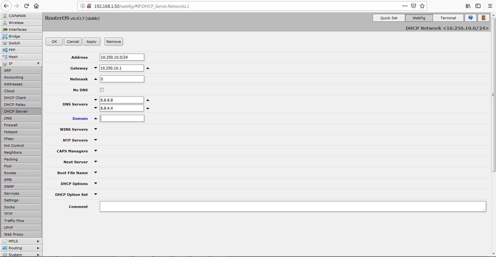

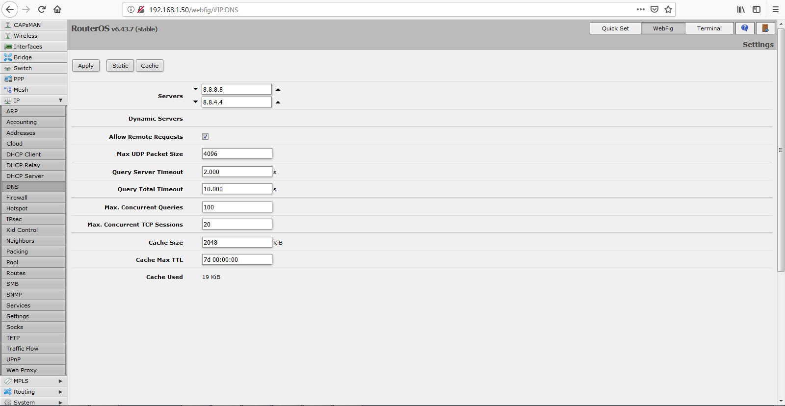

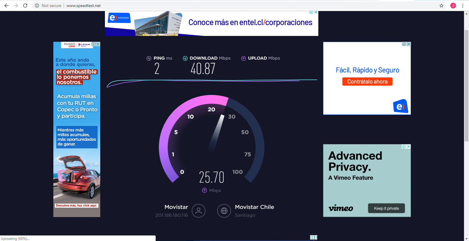

Since I did a speed test and it shows a good value, but when working it falls. I notice that when translating DNS it takes a long time or sometimes it does not translate.

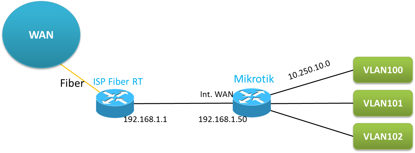

I have VLANs from the Internal side
Outside connects to a Fiber Router of my ISP
If I perform ping and tracer tests in the Firewall it works fine.
The same tests from the Vlan works badly.

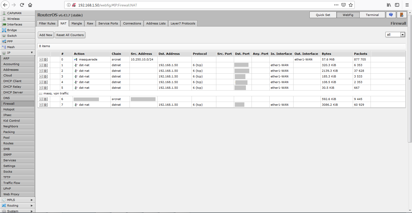

Some configuration of NAT Masquerade may be wrong.
I attach captures of my configuration and Topology.

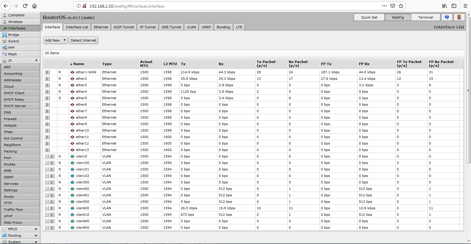

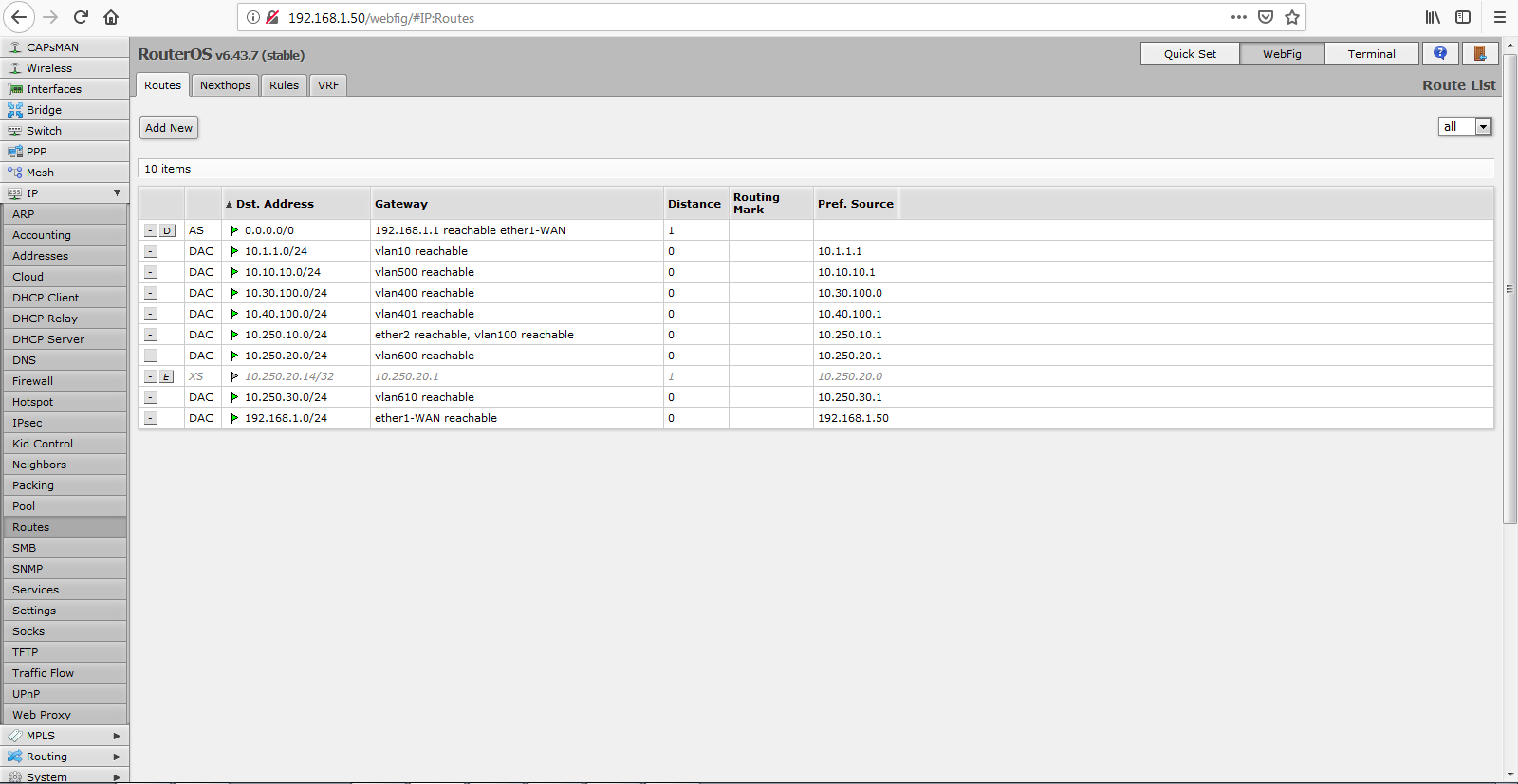

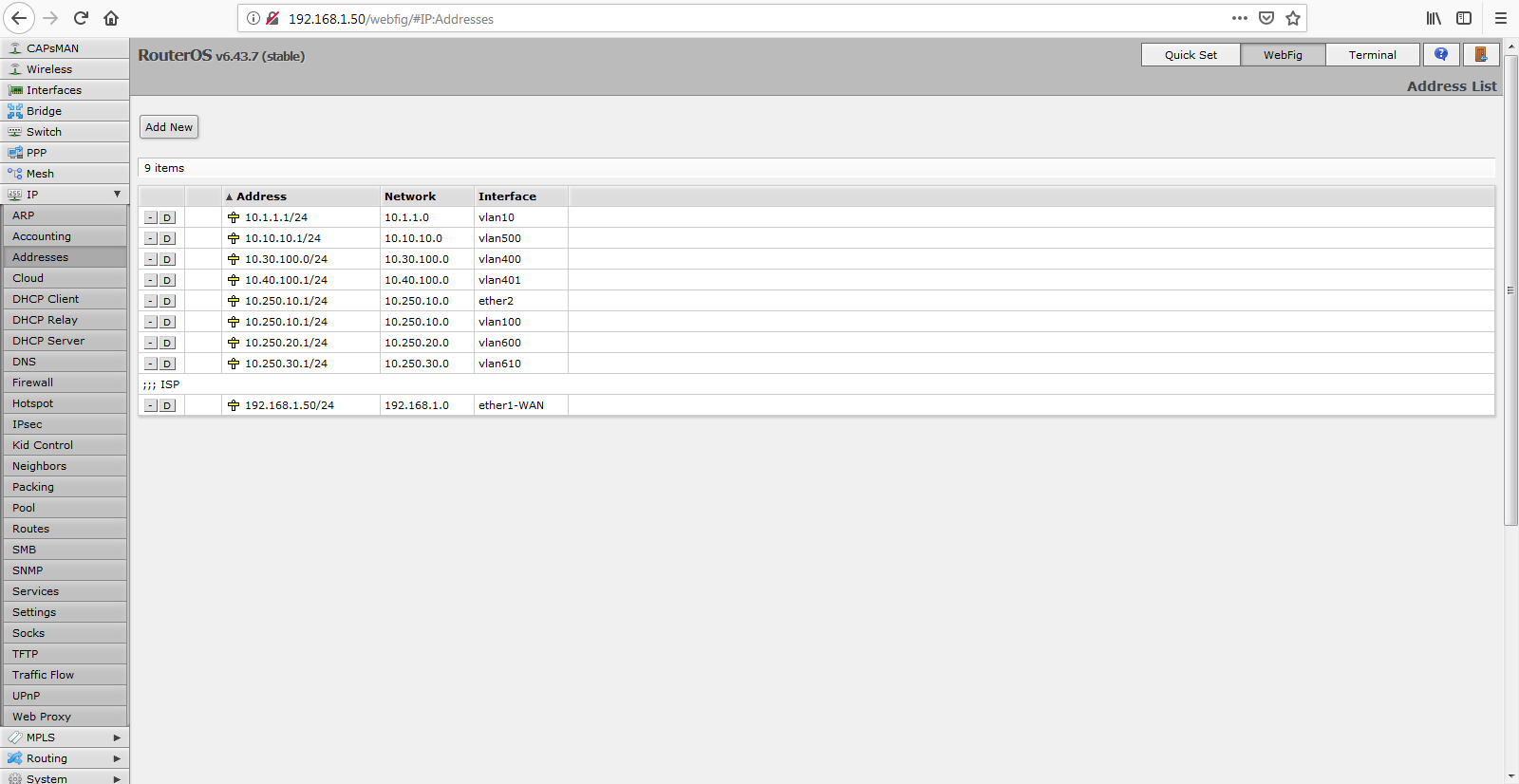

Not sure what is exactly happening there but you have assigned same IP and network range to ether2 and vlan100 (10.250.10.1/24). That does not sound right and I would guess it is a source of your trouble. I assume this issue occurs only on vlan100 or ether2, while it does not occur on other interfaces, right?

Thanks for the warning, about the slowness is in all VLAN interfaces. In the same way I deleted the duplicity of IP, because as you say it is not correct. But the slowness continues :frowning:
