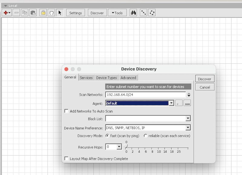

After installing the dude, the local network was scanned by auto and mapped, playing around I made lots of mess and did all devices deletion from local map thinking I will be able to do auto rescan but not only I see I have to add networks to be scanned I do not see the option to auto-scan local network. Any advice on that?
When we press Discover button it propose us to scan networks and by default local one is set in the list
