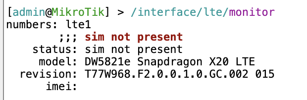

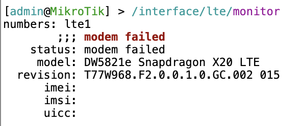

I’m trying to get the Dell DW5829e-eSIM to work as an LTE modem for SXT LTE - I saw it in the hardware listing and thought it would work without issue.
Using the “physical” SIM slot (0) RouterOS correctly warns me that there is no SIM, while if I switch to slot 1 (eSIM), it gives me “modem failure”.
Has anyone successfully installed and configured this module?
