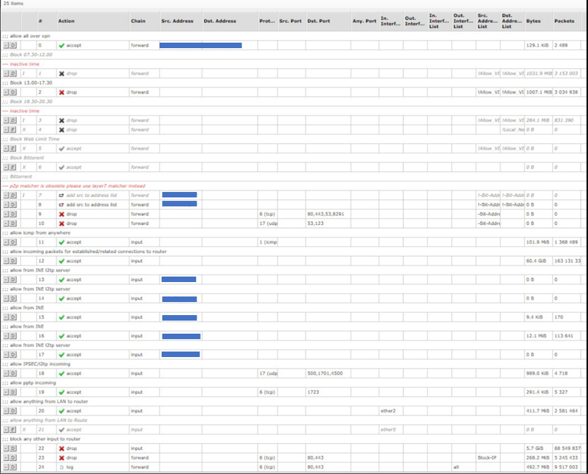

Anyone got any ideas on how I can verify if I already have “deny all” rule set up with my Mikrotik firewall? If not I would like to set it up.

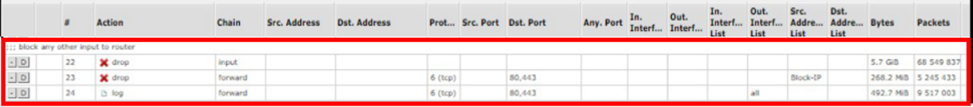

Attached a picture that shows the firewall settings page. I cant see details in items 22 and 23, but i think this might be related to “deny all” rule. Is there any other way to check?
Rule 23 is definitely not a “deny all” rule – it only denies traffic that matches the specified source address list.
Rule 22 “looks” like a deny all rule, but it’s impossible to tell from a Winbox window whether or not there are additional conditions set in columns that are not selected.

Tried exporting firewall filter and nothing came out for line 22 instead, a bunch of blocked IP came out for line 23. @macsrwe like you said its definitely not line 23.
I will try exporting line 22 again tomorrow. But looks like either its already “deny all” so nothing came out or im doing something wrong.
