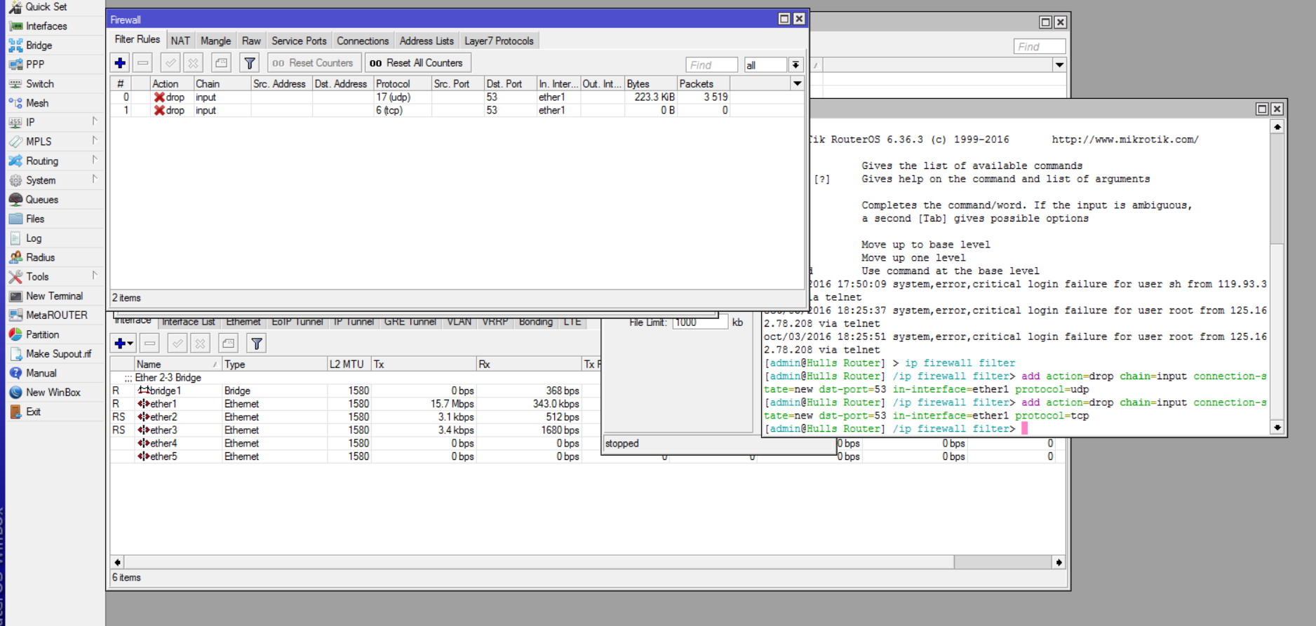

I’ve tried this and it’s not working. If you look at my interface list, you see ether1 pumping out 15.7mb of data. Nothing coming from LAN side. I have “allow remote requests” enabled so that my customers can use this as their DNS server. It appears I’m being attacked, and have been researching for 2 days trying to figure out how to stop this. I added the two rules you said, as you can see, why isn’t it stopped?
See the connection tracking table and torch the ether1 to know what the traffic is. Anyway your firewall is not secured at all.
