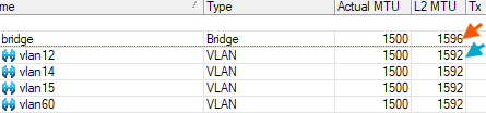

If you don't use VLAN or MPLS etc... then you can set MTU = L2MTU without problem. Also if you add a VLAN interface on top of an ethernet or bridge interface, the L2MTU of the VLAN interface is automatically reduced from the L2MTU of the parent interface, so for that VLAN interface you can set MTU = L2MTU (of the VLAN interface) too.
