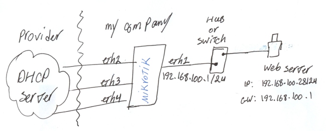

destination nat with dynamic ip
i this case i need to map an valid IP address to my web server
provider give me 10Dynamic ip address per each line
i know the dst-nat with static ip
/ip firewall nat add chain=dstnat dst-address=10.5.8.200 action=dst-nat to-addresses=192.168.100.28
/ip firewall nat add chain=srcnat src-address=192.168.100.28 action=src-nat to-addresses=10.5.8.200
but i dont have any static ip
can anybody help me to assign an ip to my webserver
also i need to use dynamic dns to resolve this webserver
thanks

i don’t have any static IP to dst-nat, only provider have IPs and give us with his dhcp server
my question exactly is how can i do the dst-nat for my webserver without knowing the public ip?
This is exactly the situation that you have - provider givers you dynamic IP address. So you have to run a script which will check what ip address is set on interface by dhcp server and then script will set that ip address in nat rules.
i explain my situation more and write exactly command that i use
ether1=connect to lan
ether2,3,4=dhcp-client
ether2=ip2,gw2 ether3=ip3,gw3 ether4=ip4,gw4
/ip address add interface=ether1 address=192.168.100.1/24 disabled=no
/ip dhcp-client add interface=ether2 use-peer-dns=yes add-default-route=yes disabled=no
/ip dhcp-client add interface=ether3 use-peer-dns=yes add-default-route=yes disabled=no
/ip dhcp-client add interface=ether4 use-peer-dns=yes add-default-route=yes disabled=no
/ip firewall nat add chain=srcnat action=masquerade disabled=no
/ip route add dst-address=0.0.0.0/0 gateway=gw1,gw2,gw3
now we need 2 ip to assign ether2,first for ether2 and second for destination nat to 192.168.100.28
when i want to run this command
MikroTik say to me :" Could not add new dhcp client- dhcp-client on that interface already exists(7)
how can i have 2 IP address and use one of them to dst-nat for my webserver

Well, dhcp client can add only one IP address per interface.
and how can i do dst-nat?
you cannot add two or more dhcp-clients to one interface
you may try to use bridge to your client, so that your client receive an IP address from your provider’s server
If you can’t get second IP then you can’t set dst nat :slight_smile:
One option is to bridge public interface with interface where web server is connected. THat way server will get one of addresses that provider assigned to you and no DST-NAT is needed.
Another option is to use metarouter to get another IP.
http://wiki.mikrotik.com/wiki/Metarouter
Chupaka it’s correct, but if i use bridge i can’t use load balancing in my webserver
by this way only webserver can have valid ip address
i right ?
what kind of load-balancing do you need for web-server?.. you are running two parallel web-servers?..
no dear friend
only i use 3512KB upload bandwidth
i connect 3
(1536/512) to mikrotik and also connect webserver to mikrotik(lan ether)
i want to use all upload bandwidth by load balancing
if i use bridge between 2 interface i can’t use all BW upload for my webserver
at first, you should use DNS load-balancing on your three addresses of those three connections - you cannot upload via different uplinks with one src-address, I believe - your ISP will block that
how can i configure DNS load-balancing?
simply add several ‘A’ records to the DNS server which hosts your domain
