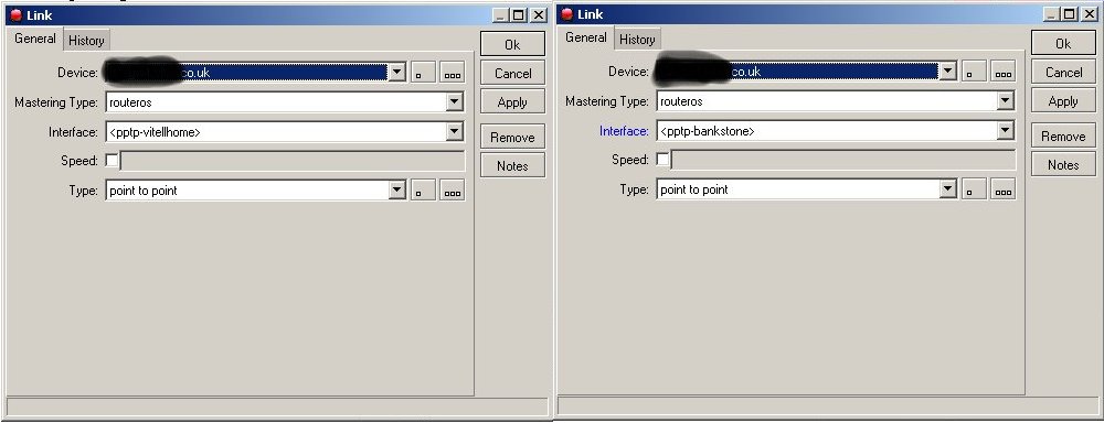

I want to monitor the state of remote sites which are semi-permanently connected by a PPTP link. The interfaces to use are therefore signified by (where X is the login name used).
If the link is configured to use the interface, everything works fine until the interface drops (the remote site logs out etc.). Then The Dude changes the interface for that link to a different interface, . The two picture bwlow shows the link definition before and after the interface drops.

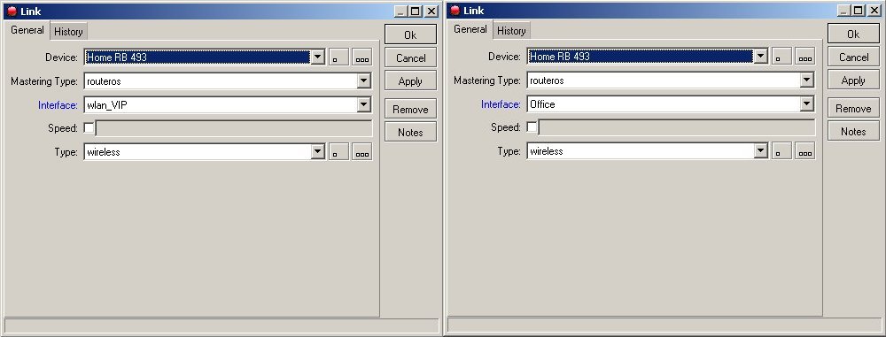

The same applies to any interface which disappears and then reappears. Whilst this may not appear to be a problem, the fact that an interface has disappeared is important and should be reported to us. Consider the case of a remote site accidentally deleting a wireless link - The Dude will pick a different interface and then monitor that instead. We wouldn’t know about the interface going down until the end user contacts us. This picture below shows the state before and after a wireless link is deleted.
I can see no reason why The Dude should change the interface it’s graphing/monitoring/using - especially so since the change appears to be random and the link status will be incorrectly reported from that point on. Surely this completely defeats the whole point of monitoring software?
