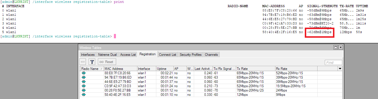

Detect 1Mbps data rate
Occasionally when customers complain about slow service it can caused by 1Mbps date rate being used and a reset and reflash solves the issue, but is someway I can locate from the AP any CPE’s that are using 1Mbps rather than manually open each one?

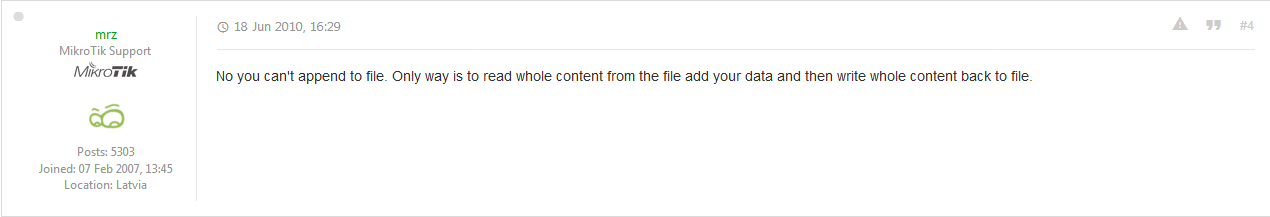

Next step if I could suggest is to write to a new file which contents could be cleared (or deleted) once the email alert is sent,as default logs cannot be deleted (log line size reduced maybe)
http://forum.mikrotik.com/t/how-to-clear-log/24416/23
Here is a script I use to detect routing errors from the logs and send a email, not sure if this can be of help ( it also needs to read from separate file and not the default logs?)

please be more specific about this problem.
1Mbps data-rate is valid for B/G/N standard. But in the picture the 1Mbps rate was used 6hours ago with low signal and since then it is not used.
What kind of wireless client it is?
What is the distance setting?
What RouterOS version and wireless settings you have on the AP and the CPE?

As a WISP we have had CPE’s that when a customer complains about a slow service, we call and discover that 1Mbps data rate is listed and true service is slow, our solution has been to (a) reset and (b) reapplying our custom configuration file to the CPE!
edit cut
As i wasn’t aware of this issue until a customer complained but luckily this has only occurred to very few CPE’s, but we need the script to alert us as our concern is that some customers will not complain about a slow service but will instead switch to another provider.
Uldis how accurate is “last measured”,
My guess as the service is slow that there is a mixed up data rate should be either 1, 2, 5.5, and 11 or 6, 9, 12, 18, 24, 36, 48 and 54 but not 1,6, 9, 12, 18, 24, 36, 48 ,54 ?
5Ghz-only N was A/N now all CPe’s are N only
8 -12KMs
First noticed on V6.35 and since then I check this when a customers complains about streaming is buffering?
