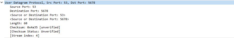

It looked like an attack, every second a connection came in on port 5768 and that is rather specific for Mikrotik routers. So this morning I started WireShark to see on what port Detect Internet was using to contact Google. Yes you guessed it, it was port 5768.
I think that it would be better to use random outgoing ports for Detect Internet.
I can’t block the Detect Internet requests but the RAW rules will see the fall-out of Detect Internet.
