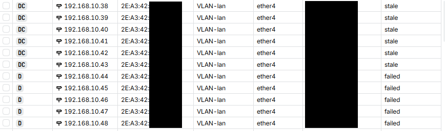

I see duplicates in the ARP table:

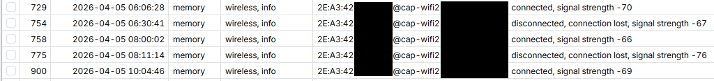

Wireless logs during a change of IP of the device, note that it has not roamed to the other AP, nor it changed frequency (cap-wifi2 is 5GHz):

/ip/arp/remove [find where !complete]

According to your screenshot, the device seems to lose connection to the APs every few hours? Is that due to roaming? Or did the device leave the location?

And the logs:

There are no duplicates on the ARP table and as far as I know the user no longer experiences random loading hangs on websites.
