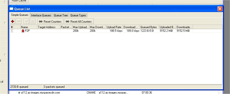

I have experienced some strange behaviour with detecting P2P with 3.x. As simple as this:
I have made a simple queue in a CPE of a user in order to limit all P2P traffic to 200k/200k. He has RouterOS 2.9.46:
/ queue simple
add name=“P2P” dst-address=0.0.0.0/0 interface=all parent=none direction=both
priority=8 queue=default-small/default-small limit-at=0/0
max-limit=200000/200000 total-queue=default-small p2p=all-p2p disabled=no
Everything is fine. The user uses his eMule and I can see that the queue is limiting the traffic correctly, so, the queue is completelly in red and limiting up and down to 190-205k. When I list on connections I can see that P2P columm marks “eDonkey”.

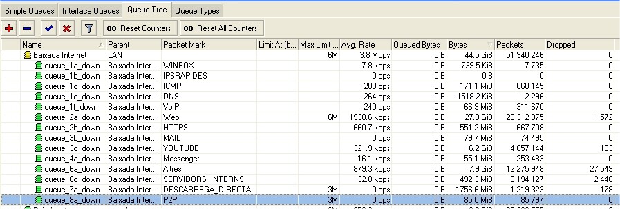

Next to my Internet connection I use a QoS structure as described in http://wiki.mikrotik.com/wiki/Mangle%2C_Queue_Tree_and_prio_by_fly_man_…_almost_done and it is more or less the same that what my trainers explained me in my Mikrotik’s Certification Course. I try to mark in mangle all connections and packets P2P. When I list on connections list I am just able to see in the P2P columm “bit-torrent”. I thought that I was doing something wrong so I just disabled all mangle marks and queue trees and I added a simple queue like the one I added in my user’s CPE. The simple queue is not detecting the “eDonkey”.
The only difference that I can appreciate is the RouterOS version. My user has a 133C with 2.9.46 and next to the Internet connection I use a 600 with 3.4. With the SAME queue rule the first detects eDonkey and the second no. But the traffic is there!

I try to attach You the CPE in the user side and what I see in the QoS Router. The CPE has 2.9.x and the QoS Router 3.6 and the queues are as simple as “detect all-p2p”. I detect P2P traffic on the user side but not in the QoS Router side. How could it be possible?
