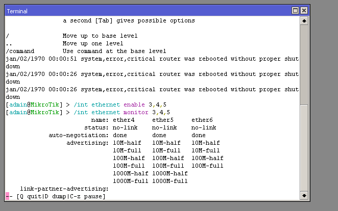

Just for fun, try running “/int ethernet enable 2,3,4”.
Does “/int ethernet monitor 2,3,4” register any changes when you plug or unplug devices into those ports?

> /int ethernet monitor 3,4,5
                        name: ether4     ether5    ether6
                      status: link-ok    link-ok   link-ok
            auto-negotiation: done       done      done
                        rate: 100Mbps    10Mbps    100Mbps
                 full-duplex: yes        yes       yes
             tx-flow-control: no         no        no
             rx-flow-control: no         no        no
                 advertising: 10M-half   10M-half  10M-half
                              10M-full   10M-full  10M-full
                              100M-half            100M-half
                              100M-full            100M-full
                              1000M-half
                              1000M-full
    link-partner-advertising: 10M-half   10M-half  10M-half
                              100M-half  100M-half 100M-half
                              100M-full  100M-full 100M-full

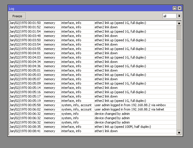

Are there any entries in /log print related to those ports?

had tried numerous devices (Hackintosh that works on port 2 at Gb as well as Broadband Cable modem that works on port 1) Also tried another RB2011 unit that a friend picked up to see if the port would link between them (that failed as well).
for the test now i used a Picostation M2HP
