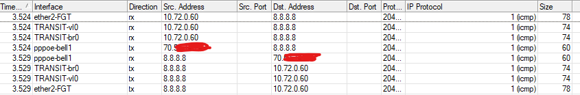

Have a look at Image1 to see a packet from a device located at CENTRAL go through the Mikrotik there and get NATed normally.

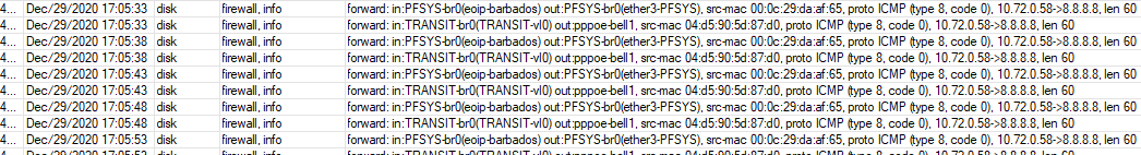

Now, look at Image2 to see how a packet coming in from the eoip tunnel is sent through the same external interface, but without being NATed at all? As you can guess, this just doesn’t work.

I’ve added two firewall rule with idea of logging packet:
add action=masquerade chain=srcnat comment="NAT out" log=yes out-interface=pppoe-bell1 src-address=10.72.0.58
add action=passthrough chain=forward log=yes src-address=10.72.0.58
And the result is only the forward passthrough that is actually getting logged. So, for a reason I don’t get yet, the packet is not being considered by the masquerading rule:

The problem is, everything located at the REMOTE site can’t access the internet. From a layer 2 perspective, they access the Internet through the router at CENTRAL (by going through the bridge between site) but for a reason I don’t understand, the router at CENTRAL doesn’t masquerade packet coming from device on the other side of the bridge when they are sent on the Internet. As you can see in the image above, the device 10.72.0.58 is located at REMOTE and when accessing the internet, the router at CENTRAL send the packet from that device through the pppoe-bell1 interface as 10.72.0.58 insterad of masquerading it behind 70.x.x.x (which is my external IP address).
Anything coming from the same subnet but physically located at CENTRAL (therefore not going through the EoIP or BCP bridge) gets NATed correctly when accessing the internet.

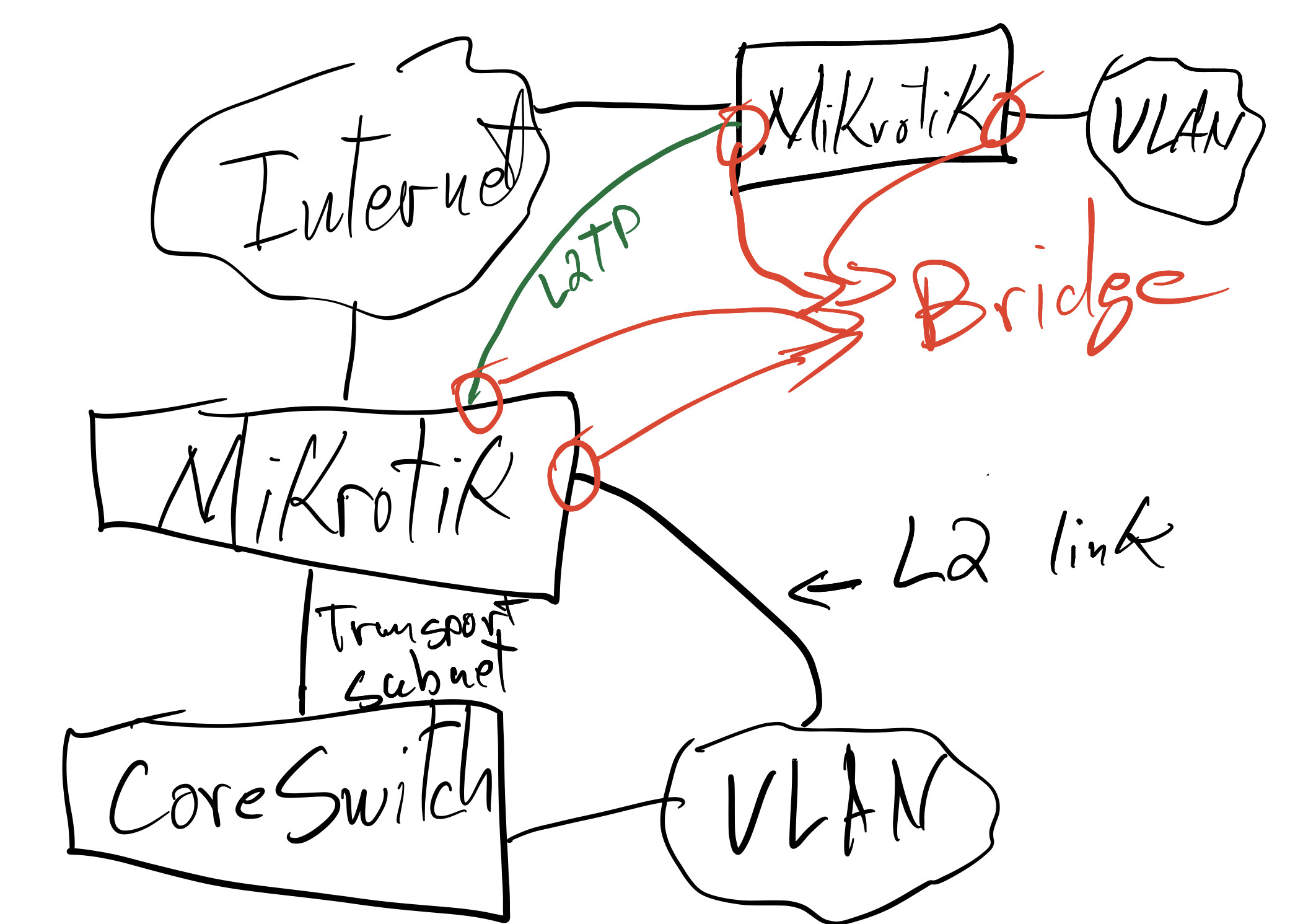

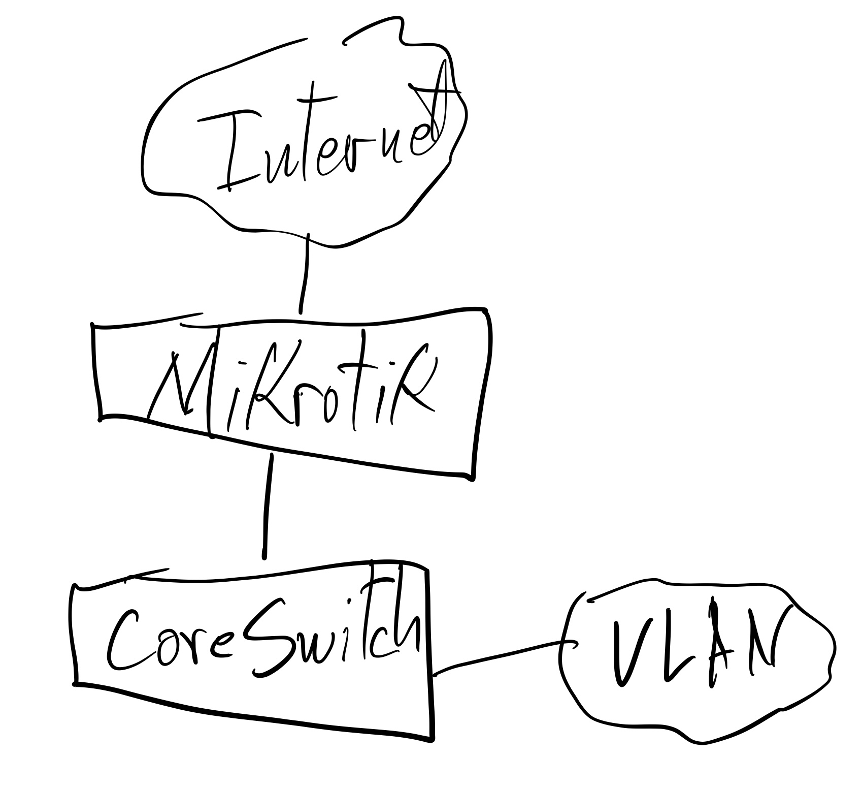

One thing I didn’t mention, thinking that it wouldn’t have any impact (but it clearly has, see below) is the fact the that network that I am trying to bridge is located (L3 speaking) behind a core switch. It is not (again, L3 speaking) directly connected to the Mikrotik itself. I connected it (L2 speaking) to the Tik by using a cable between the Tik and the core switch. That interface in the Tik is the one bridged with the L2TP through BCP.
See this to have an simplified idea of how the network is built:
See this to have an idea of how the bridge is configured:
I did some more testing by creating an interface directly connected to the Mikrotik (both L2 and L3) and bridging that interface with BCP instead of the VLAN behind the core switch. Suddenly, those VM are able to access the internet, the Mikrotik is NATing as it should!
So, there is clearly something that the Mikrotik doesn’t like with the fact that bridged network is not directly connected to the Tik itself. Probably has something to do with the ARP being learned by the bridge. That’s the only difference I see between a device physically connected at CENTRAL and another at REMOTE is that the one at CENTRAL is behind the core switch and the Tik never learns it MAC address and the one at REMOTE gets learned by the Tik through the bridge.
