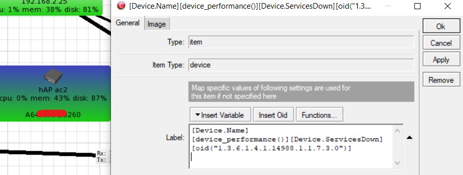

I want to know if there is way to use OID function to get the device serial number to show on Dude. I tried a few different ways but I keep failing. I need to gather all the serial numbers for all my connected devices and give it through to management so that is why I want to set Dude to fetch it as it will be very tedious and time consuming to go through every device and gather the serial number.

Did you check this Serial number oid via snmp… ?
SnmpWalk, right-click-copy-OID, paste in DUDE label (some editing= [oid(“…”)] )
