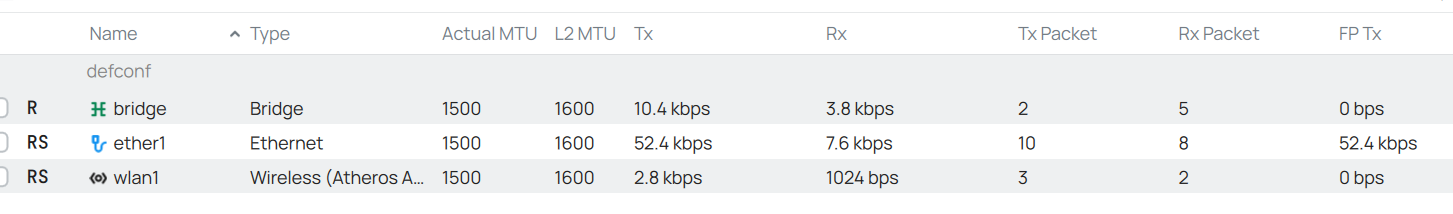

So i have now activated the loop protection:wlan1: bridge port received packet with own address as source address (48:a9:8a:e4:e6:9d), probably loop
I dont know whats happend in the devices ! there is no physicaly loop
And i think the configuration is one of the smallest see picture
