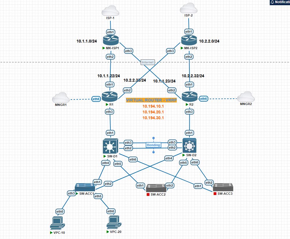

Hi everyone,
I came up with this Mikrotik LAB:
I set VLANs over a VRRP configuration, but it seems that devices at the end (VPCs) can’t get IPs from the DHCP server.
here are the routers and switches’ setups:

Could you please help me fix the problem?
There might be a problem with routing since VPCs can’t ping their gateway even I manually set IP addresses on them. Unfortunately, I can’t see the wrong setup.
Hi!
DHCP needs L2 interface and not L3 interface.
The another problem is DHCP failover and DHCP lease database sync. ( R1 → R2 or R2 → R1 ) the solution to the entire problem ( VRRP, DHCP ) called “Virtual Chassis/Stacking” ( 2 physical device in 1 logical device ) - but this is not exists in Mikrotik devices ( unfortunately ).

This part will hardly work:
add address-pool=dhcp_pool0 interface=vrrp10 name=dhcp1
add address-pool=dhcp_pool1 interface=vrrp20 name=dhcp2
add address-pool=dhcp_pool2 interface=vrrp30 name=dhcp3
fixed:
add address-pool=dhcp_pool0 interface=VLAN10 name=dhcp1
add address-pool=dhcp_pool1 interface=VLAN20 name=dhcp2
add address-pool=dhcp_pool2 interface=VLAN30 name=dhcp3
I modified the dhcp server setup but devices still can't get IPs though. Thanks

Nope! Furthermore, hasn't VLAN tagging on the bridge always been a Mikrotik thing?
Thank you
FIXED! I missed to set PVIDs UP!
Thanks anyway
