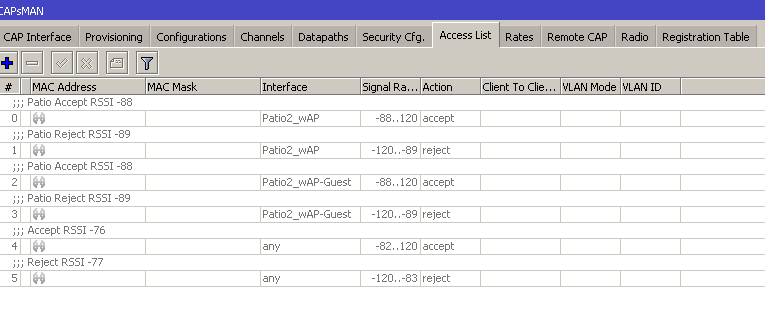

I’ve went and disabled my access-list rules for giggles…
I also rolled back my channel configurations on 2 & 5Ghz.
Prior I had 2Ghz configured for 2-Ghz; only-n. 5Ghz- onlyac…

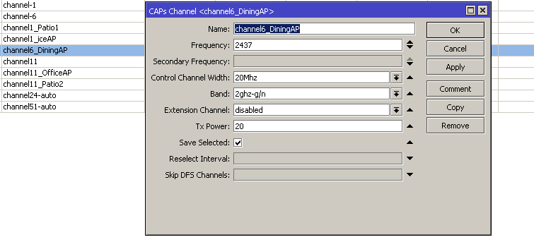

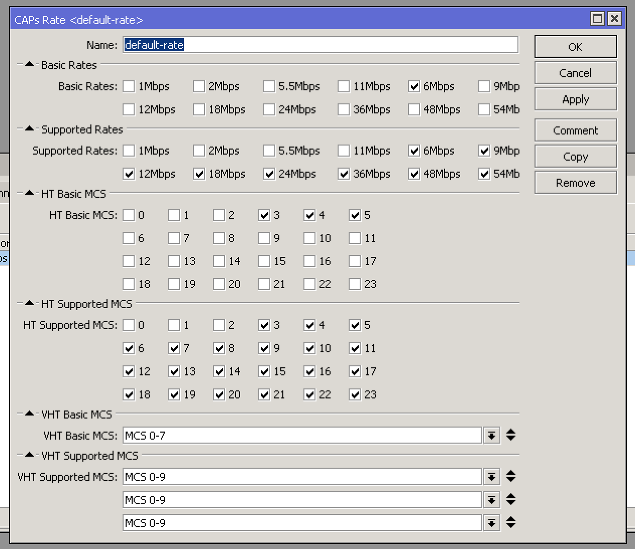

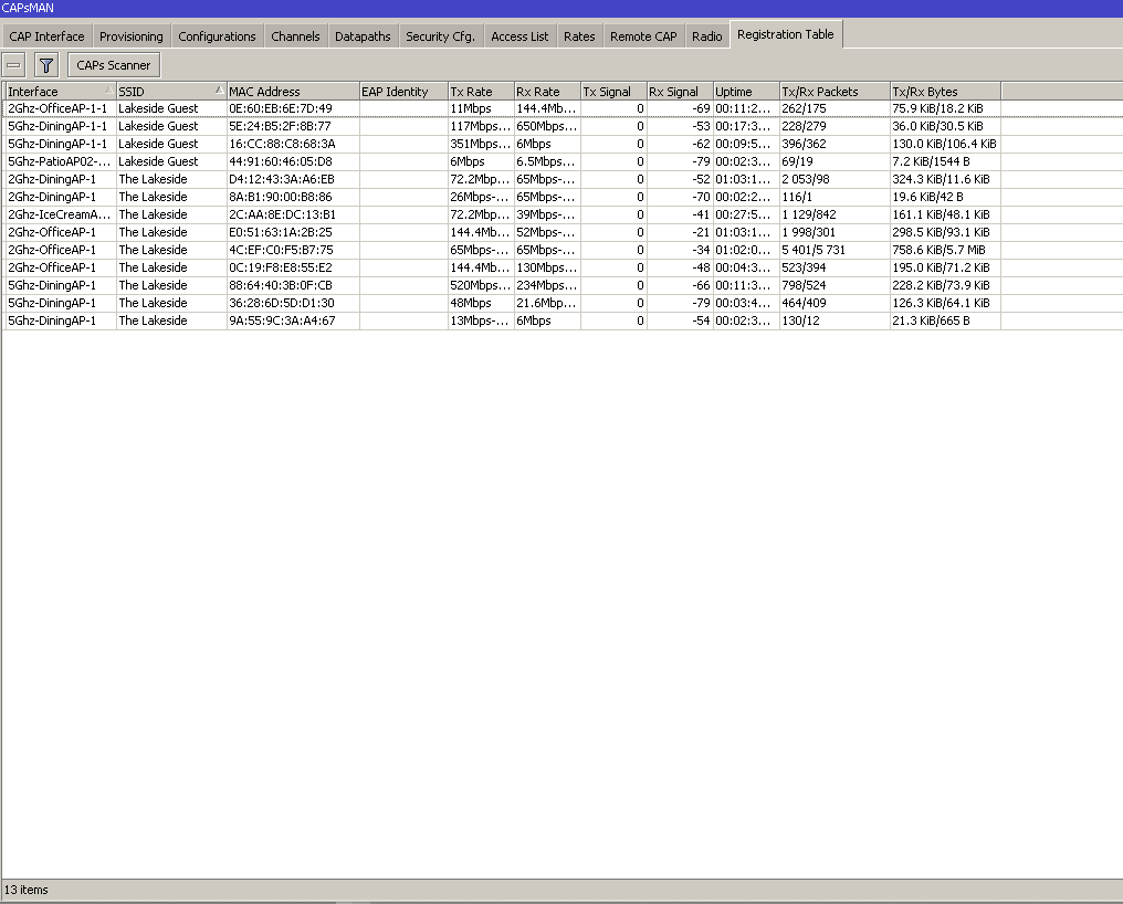

See screenshots:

Screenshot 1:
I’m missing CCQ as information. Sometimes the signal strength is OK, but with a very poor CCQ. (And it is not always because you pass a wall).
Signal strength looks good, the low 6Mbps/6.5Mbps rates are from devices which had no traffic yet.
Uptimes are rather short, but even then most volumes are much lower than expected.
No “sleeping” smartphones? You need “last activity” as column. That time will go up to 10 sec and then reset. (That’s why in my access-list “allowed out of range” > 10 sec)

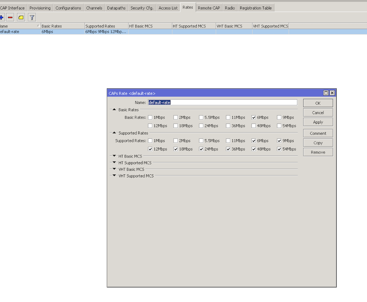

Screenshot 2:
The cable plugging user allowed me to finetune the access-list values when there was poor coverage.
My basic setting with tipping point at -86dBm for 2.4GHz , and -83 dBm for 5 GHz has been adjusted FOR MY SETUP to -83 and -80, to make roaming more effective.
All power at the legal max value for ETSI. More than 50% of the devices select 5GHz. Only a seldom device flaps between 2.4 and 5 GHz.
(The 100+ devices are iphone, iPAD, Galaxy tablets, en a laptop here and there. I have no control as users bring them and stay for some days only)
Rising the basic rate reduces the number of access-list initial rejects, but is not very efficiënt in doing that. My hope was to use high basic rate only, but that didn’t work out as expected.
Screenshot 3:
Basic rates
12 Mbps as basic rate is the highest value I use. (Coming from 9 Mbps for several test months). No complains so far. (But I have no personal contact with the users, I only see that the same devices reconnect as before)
Supported rates
I would not use that 11 Mbps b-rate. There should be no 802.11b.
I do follow some recommendation of someone’s presentation (I forgot who) to allow lower rates than basic rates as supported. The rate will temporarily drop due to a failed packet transmission, and I do not want to drop that connection, if it is only a glitch. At the end, at beacon time, the higher basic rate will cause “no beacon received”. So I support ALL low rates.
Removing lower supported rates is a common practice in this forum. You want devices to use higher rates, OK, but forbidding the use of lower rates, is not the good answer to this in my opinion.
There are no access-lists to disconnect on lower rates, (and we know MT has no “airtime fairness” to mitigate the airtime consumption of those unwanted connections)
We only have signal strength … which leads to SNR … which leads to failed packets … which leads to CCQ … which leads to lower interface rates.
Dropping lower rates would be OK, if one had some “rate out of range” timeout.
HT basic MCS
This is very strict. MCS3 is 26-29Mbps ! This is a very high value. To be in line with the other basic rate limit, MCS1 (13-14.4) and MCS2 (19.5-21.7) should be allowed.
And there is nothing wrong with accepting MCS6 and MCS7.
Is basic rate only used in single stream? It looks like it is the case. (So HT MCS8 and up are not used)
HT supported rates
Same story as before. Support them all. You do not want those disconnects if it drops below 26Mbps for 802.11n just once.
VHT rates
802.11ac has taken away the discretionary rate accept/deny. So this is OK for 802.11ac. Not many of your clients go on 802.11ac however.
My experience only. YMMV.

I know on NON capsman controlled access points. The MikroTik default rates have everything checked. 1Mbps basic rate all way up, etc.
MT does something very strange to this supported rate setting … 5GHz-only-ac is down to 1 Mbps, 5GHz-N/AC starts from 6 Mbps. It’s in the wiki also.
If you set it to default, the previous set values are there, but grayed out. What of these settings is used? No idea!
Starting from 6Mbps is what I want, not the typical 1 Mbps B-rate. 1 Mbps fills my channel with beacon air-time!

@bpwl - Interesting tips! I did NOT know that the MT 5Ghz-only-ac is down to 1Mbps!! Do you happen to have that wiki link? I’m curious of that read.
I’ve now went and swapped back my caps configuration to be 2Ghz-g/n [previous was 2Ghz-only-n] and changed to 5Ghz-n/ac [prior 5Ghz-only-ac].
Also keeping basic rate to 6Mbps, and then support-rates from 6Mbps, 9Mbps,12Mbps - 54Mbps…
Do my rates look ok for general devices in wild to connect? I understand peoples configurations will vary! Some will be doing PtMP / PtP links and need very specific Basic and supported-rates between THEIR radio’s! Different animal.
Mainly looking for the typical consumer configuration where all we care about is device connectivity. wheeee!

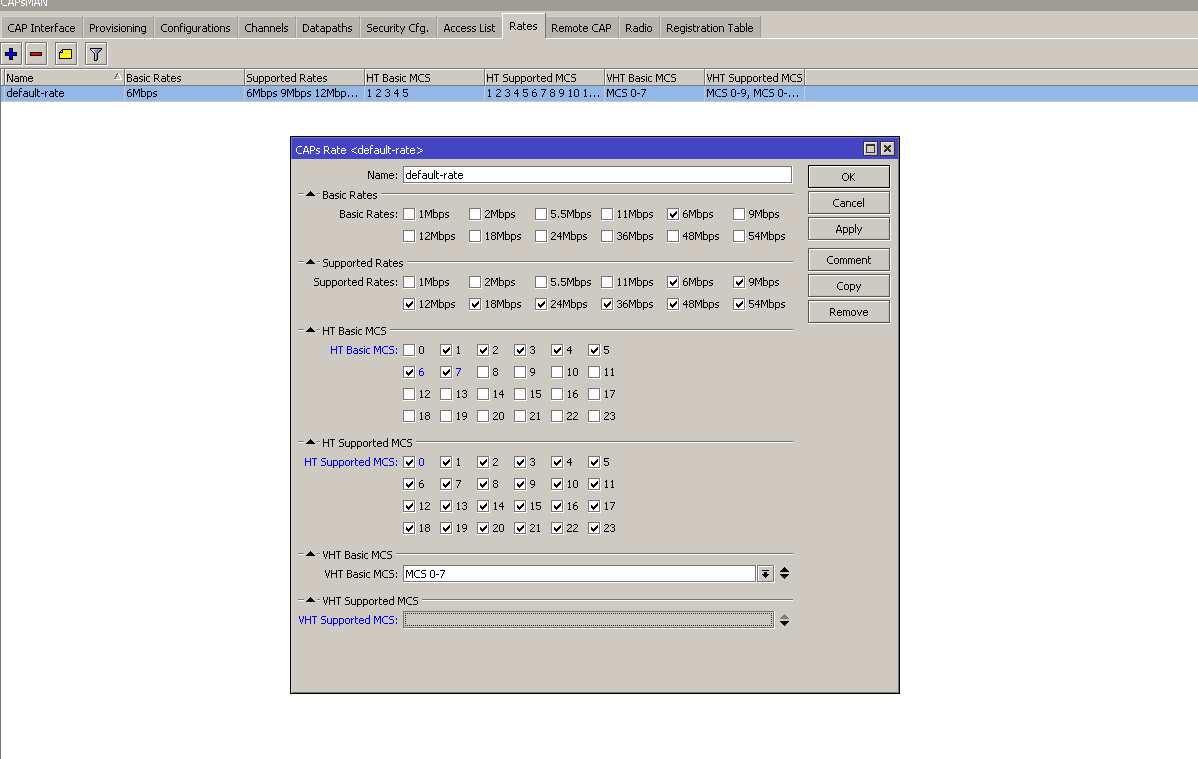

Attaching my revised rate-configuration for this deployment. I’ll let it ride for a day or two before turning back on my access-list rules
Revised the following -
set basic-rates to be 6Mbps.
set support-rates to be 6mbps, 9Mbps, 12-54Mbps
adjusted HT-Basic-MCS to be 1-7
adjusted HT-Supported-MCS to be ALL
VHT-Supported-MCS – set to MT Defaults [should be all avail].

Issue was more or less self-induced due to my rate configuration. Since defaulting back to MikroTik default rates, I am seeing more devices connected to this customers guest wifi network. More than I usually see for their evening dinner service [restaurant]..

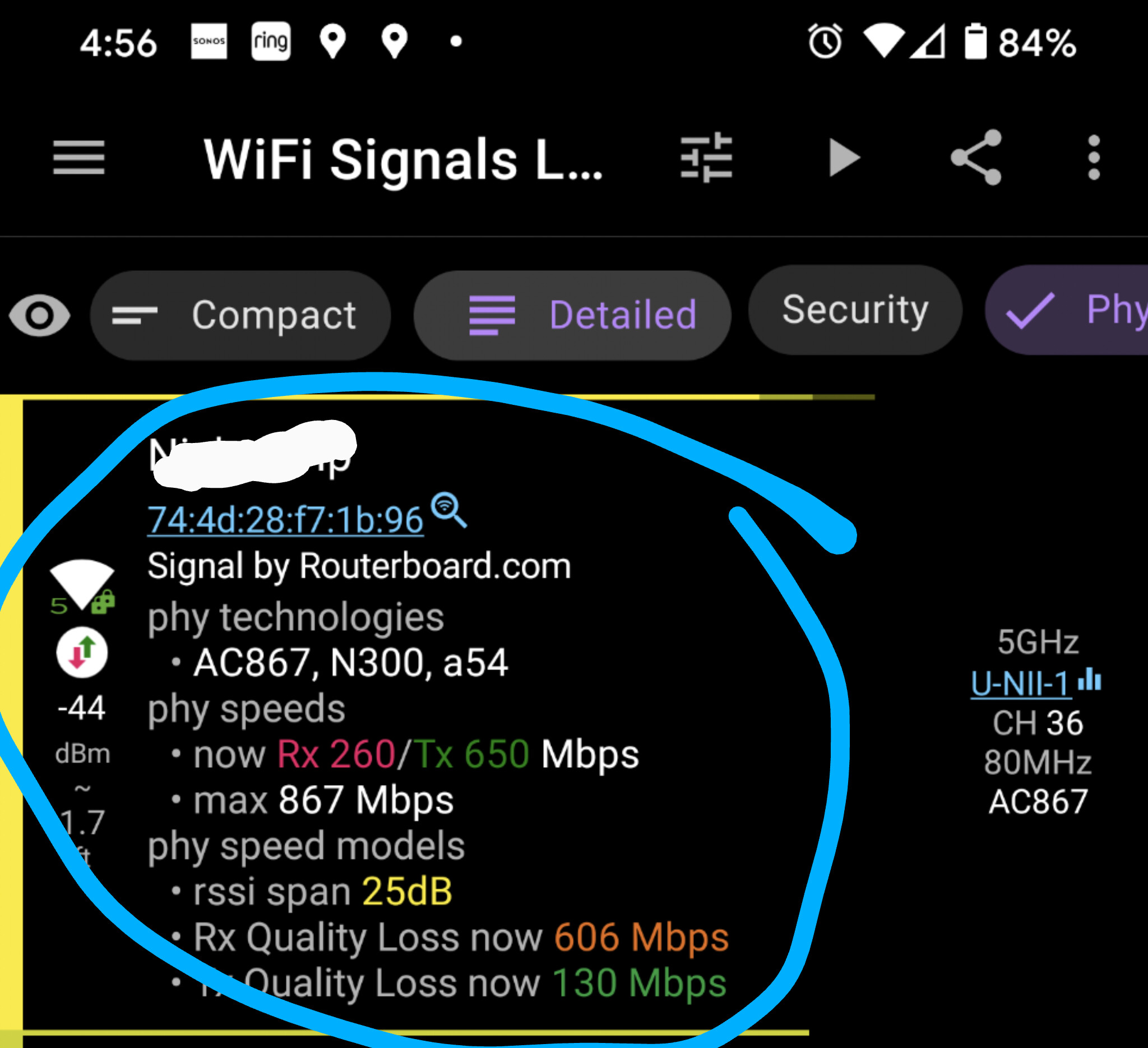

I hardwire it to my network and stick it in the dead center of my house.
It’s configured as
2.4 ch 1 20 mhz on the 2x2
5.0 ch 36 80 mhz on the 2x2
5.0/5.8 ch 149 80 mhz on the 4x4

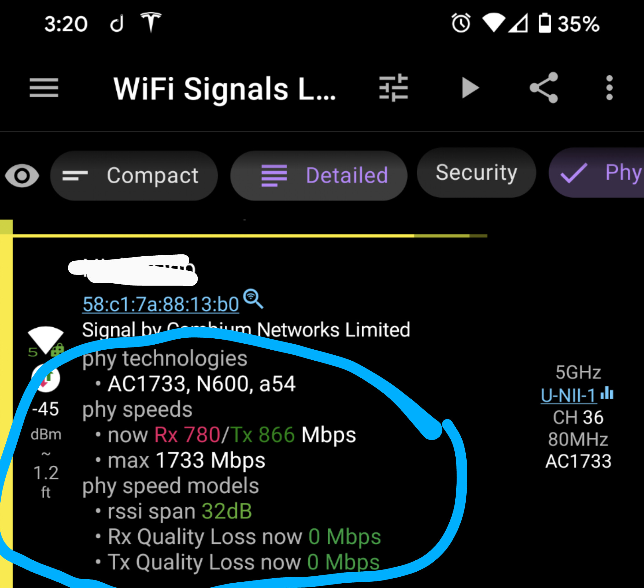

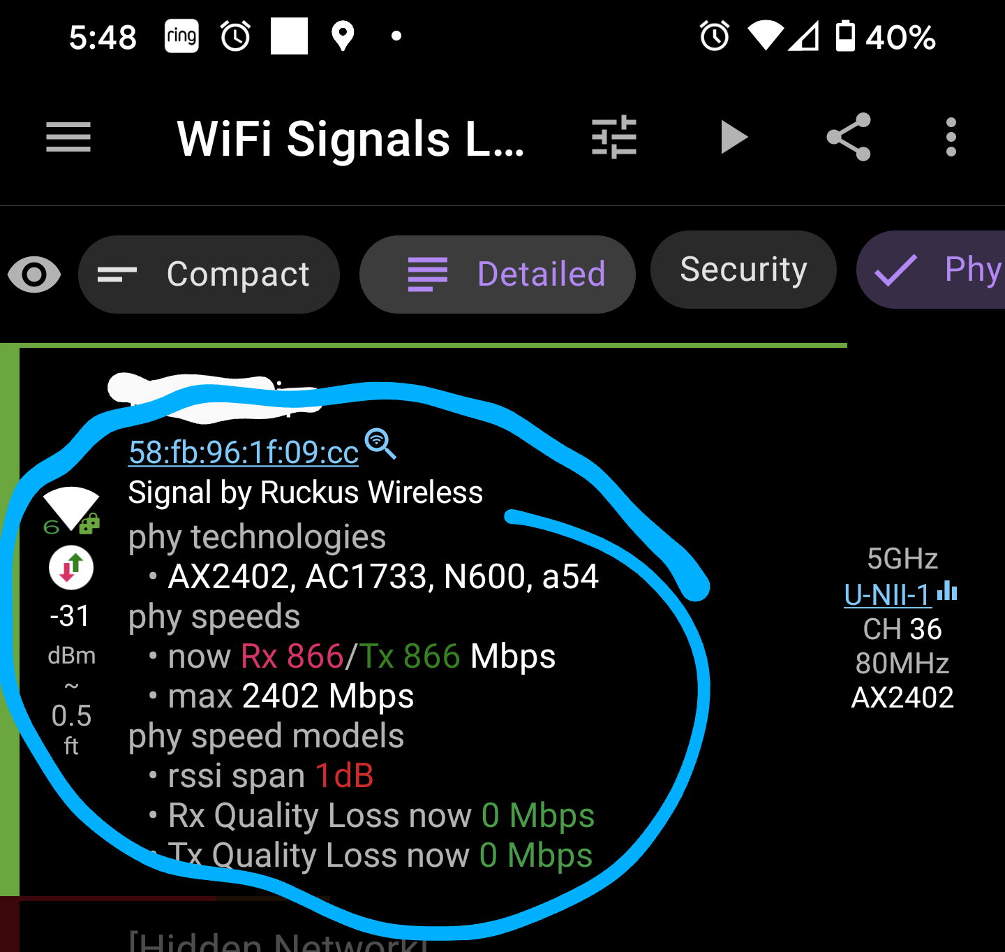

Sitting 15 feet from it… The Tx and Rx errors approach 700Mbps. And sure enough… Connections seem to be limited to about 130Megs at Best.
Flip that to UniF–k , Cambium, or Ruckus… Error rates drop to under 100M and clients tend to see a 3-400 Meg increase in throughput and far better pings. Plus, people stop having to repeat themselves on wifi calling.
