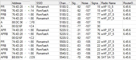

Scanning the 5GHz showed almost everything switched off by the neighbourgs except 1, and the 20 houses where well under control. All 5GHz channels are 20 MHz Ce, that is 40 MHz.
Except a hAP ac2 in number 7 was ALSO visible at 5540 MHz, though it was set at 5220 MHz. What’s this ??? Measurement was done with the wAP at the same house 7.
The reverse scan by the hAP ac2 showed the similar scenario. The wAP ac was operating at 5180 MHz , but also appeared at 5500 MHz.in the hAP ac2
Changing the freq of the wAP to 5220 MHz , made it being added to the scan list at 5220 MHz , but also at 5540 MHz.
5540MHz being the working freq of the SXT sa5 pointing obviously in the direction of house 7, and having the one “radar detect” , that I beleive is just a glitch.
The wAP is not yet mounted outside, so the signal between hAp and wAP is (very) strong. Reducing the TX power on hAP and wAP reduces the received signal strength accordingly.
But the fantom higher signal remains at the same level.(-83 dBm). And that worries me. Having fantom frequencies because of overloading the receiver should dissappear when the TX power is reduced. Or is this radiating from the hAP and wAP bodies ? Is it always there? Is that a possible reason for the false radar detect?
