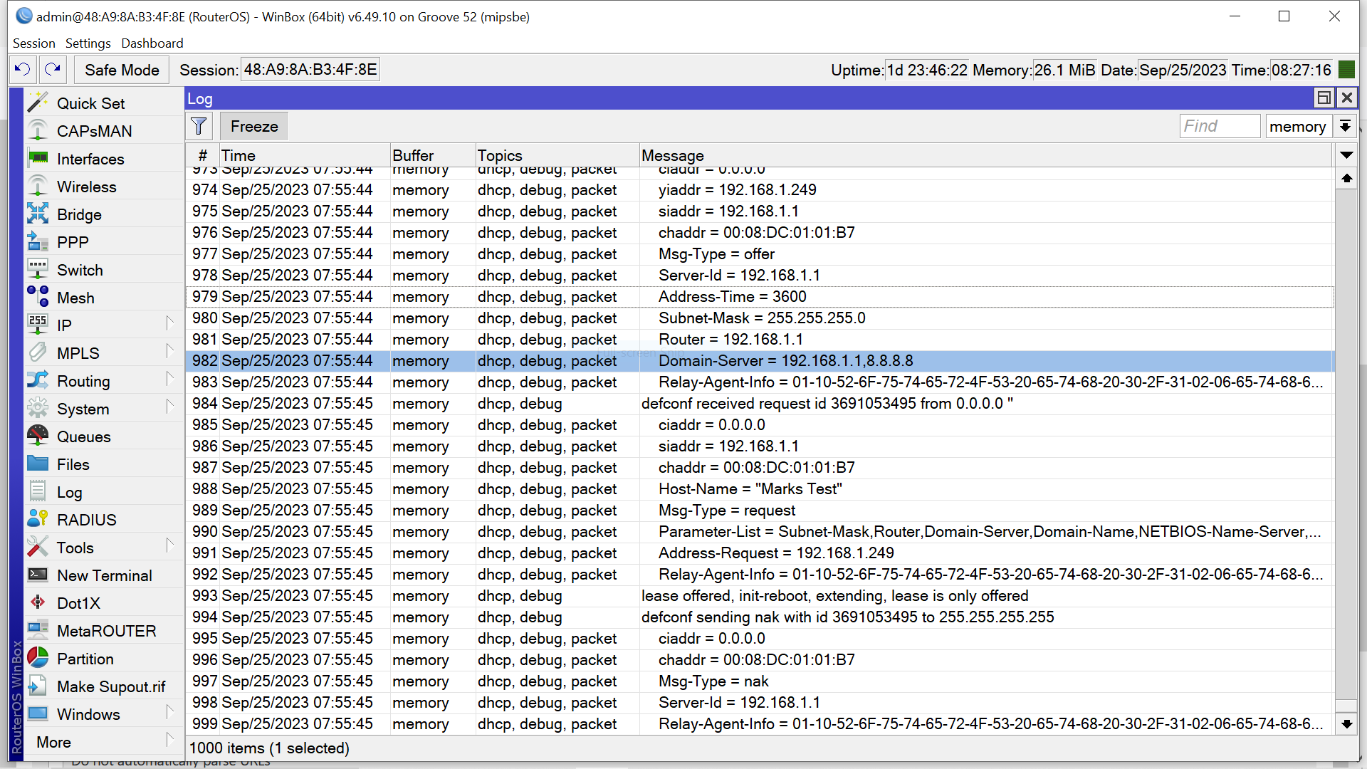

It seems my router foo is not strong enough. Routeros 6 newest. Groove newest. Device not connecting Splat SX10509 - RS485 to Ethernet converter running a wiznet W5100 with some custom config that we have no access to. 3691053495 is mac address in decimal. Ubiquity Bullet works with the device. Hoping to move to Groove if we can get this problem solved. Attached the log file with dhcp out put enabled and
. Some help please.
A little wire sharking on the ubiquity device revealed initial arp is wiznet_01:0:B7 then id369105495.local. I am guessing the dot local is an MS addition. I hope that helps.
