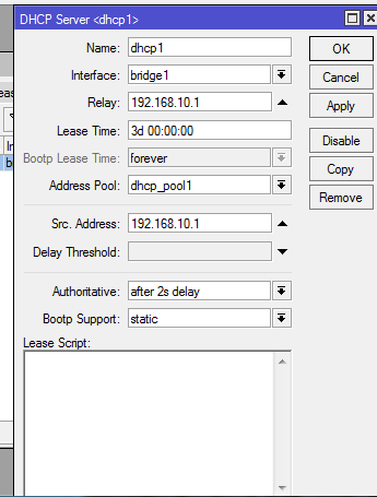

Why is there a relay entry of 192.168.10.1?

So 192.168.10.1 is the dhcp server for your network?

My DHCP Server
Set the relay and src. address settings to 0.0.0.0.
the the DHCP Server gets invalid
