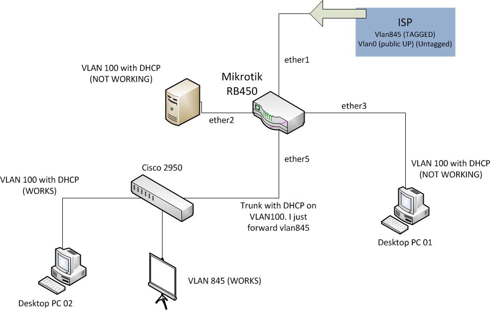

My setup is looking like this.
As you can on the picture, evertything is almost working like I want it to do.
I want to connect clients directly to my mikrotik and be connected to VLAN 100 and get an ip adress from the DHCP server.
But I cant get it working.
When I connect anything through my cisco, Its get into vlan100 (or vlan845 which I want it to be) and gets an ip adress from the DHCP and are ready to communicate with internet.

I do know that I dont have any config for ether2 and ether3, I tried to set up and br-vlan100 and connect ether2,3 and vlan100 to it, but then my dhcp-server gets invaild
And I changed interface=vlan100 to interface=br-vlan100 but then DHCP only works on the clients I have connected to my mikrotik not any client i connect to my cisco.
So my question is: How can I get VLAN100 working on both places? :slight_smile:
