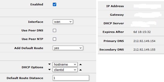

I use hex 750Gr3 with 6.49.1 and got ip configuration by dhcp from ISP to ethet1 port with DHCP clietnt. i should get one dns servers addresses but i get another i mean incorrect dns server addresses.Also i get ip & prefix & netmask & routes & gateway but they are correct. Correct i mean that my ISP sends me. i tried to change MAC on ether1 port but nothing happened, my isp for one month check their own network and found nothing.
i created a new DHCP client profile for ether1 port but nothing happened, it all started one month ago, but i used this device for 3 years and at first of may i use it last time, then turn off for six month and turn it on at first of November with no settings change, and got all dhcp settings correct except dns servers addresses.

Looks like you don’t have the DHCP client set to use the DNS servers handed… be sure to tick “Use peer DNS” , and DNS servers handed by your ISP will be used.
Additionaly, you have the “wrong ones” (212.92.149.154 and 212.92.149.155) set statically in IP > DNS servers, you need to go there and remove them.
Under IP > DNS Dynamic Servers you should see the ones handed by the ISP once you enable “Use peer DNS”.

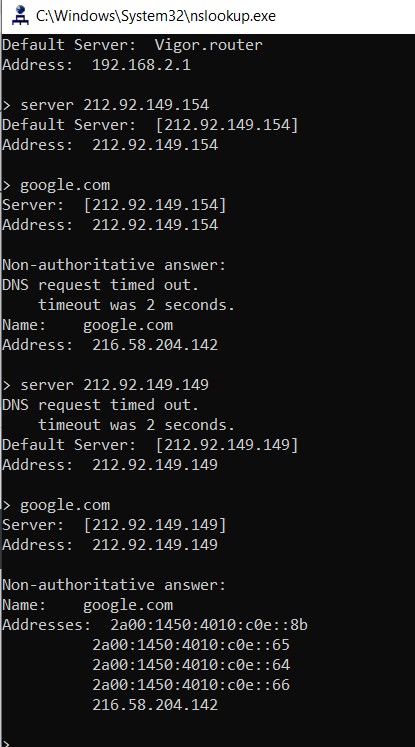

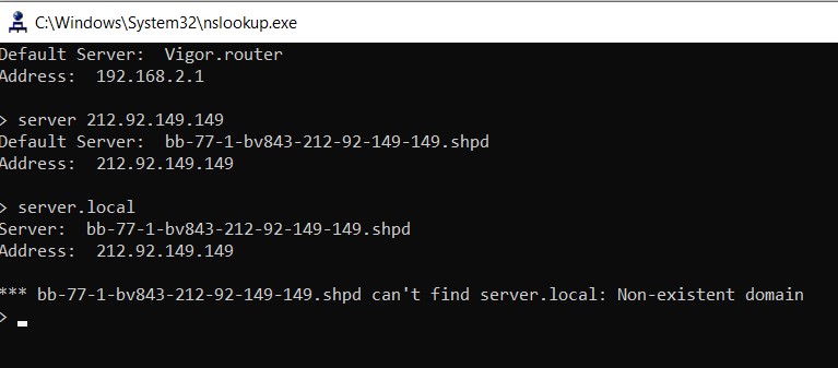

Use NSLOOKUP on your PC to see id 212.92.149.154 and 212.92.149.155 are responding as DNS servers or not.
From here they are not … but could be due to ISP filter.
- I don`t use “Use peer DNS” in screenshot because current config need it to work internet connection with working dns servers.
You see screnshot from “IP → DHCP client → dhcp client profile”. Now manually configured 212.92.149.149 and 212.92.149.150 in “IP → DNS” - 212.92.149.154 and 212.92.149.155 gets DHCP client profile in router automatically from ISP. They are not configured manually in “IP → DNS”
They are not responding my requests. Neither DNS nor pings or i can`t even make traceroute to them.

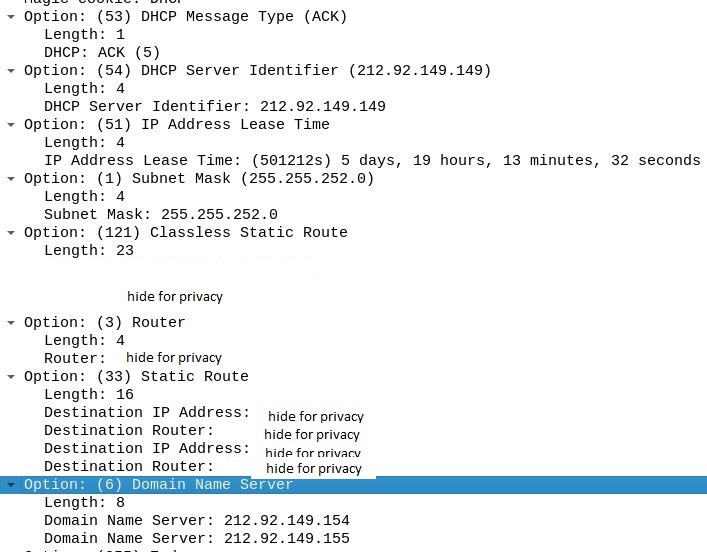

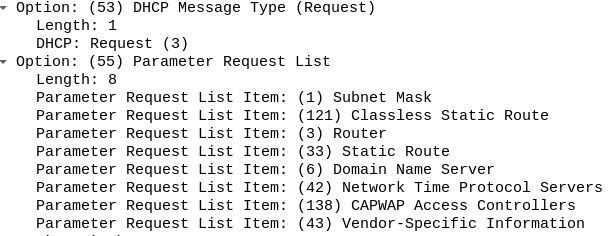

Look in the DHCP ACK to the DHCP REQUEST sent by your router. Option 6 is the DNS server the DHCP server sends you, there may be more than one of these entries.
I have never seen a case where a router or any other DHCP client rejects the DHCP servers offered and changes them to it’s own unless specifically configured to do so.
Also, you can easily disprove the “broken router” theory by connecting something else to ISP, e.g. your PC. You’ll see what DNS it gets.

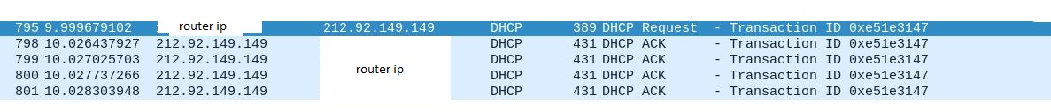

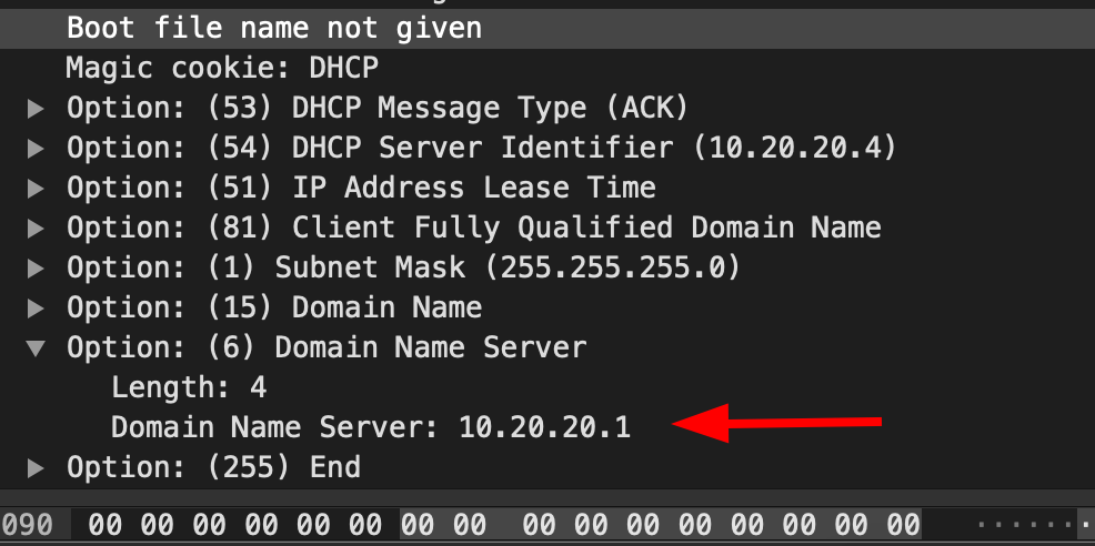

So, Traffic Sniffer from Tools in mikrotik(with stream to pc after NAT) from ether1 port(using as wan to ISP) to ethernet port of pc and Kali Linux after apt-get update &&
apt-get full-upgrade, Wireshark 3.4.9
That looks pretty conclusive, you are receiving the incorrect IPs in the DHCP ACK.
Send it back to the ISP.
Don’t assume they know more than you, I’ve worked with many who were completely lost when a problem went even slightly off-script…
Thank you. I was needed to someone except me can approve that Traffic sniffer and Wireshark is enough to prove localization of issue. Honestly, earlier i started think that some DHCP options or vlans works incorrect.

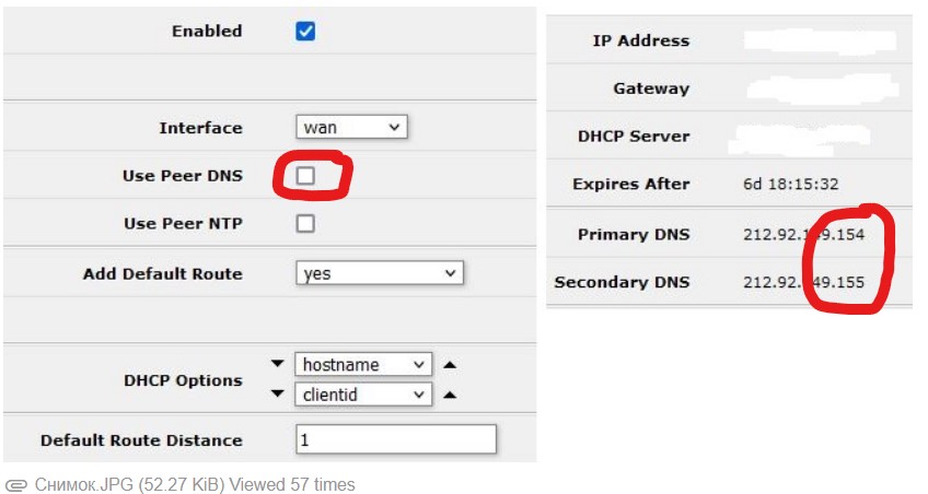

If you send proof to the ISP, then don’t send this picture, because this as one picture, interpreted as the state at 1 specific point in time, is not compatible with your story.
You can get there only when the tick was removed after receiving the lease with the “Use peer DNS” on. Confusing!
