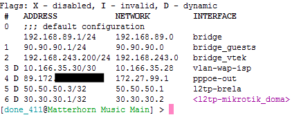

Hi attached the printed address and routes.
And, please, copy-paste text outputs (inside [__code] [/code] environment for better readability). You can obfuscate public IP address (but do it in same way in both outputs, e.g. 89.172.x.y and make sure ‘x’ are the same in both cases, ditto ‘y’).
Hi Metod i hope i did it right.

I’ll assume the info you posted is when DHCP adds default route. So the relevant bits are:
/ip address print
 3 D 178.160.xx.yyy/30  178.160.xx.yyy  vlan-wap-isp
 /ip route print
  1  DS  0.0.0.0/0                          178.160.xx.yyy           10
  7 ADC  178.160.xx.yyy/30  178.160.xx.yyy  vlan-wap-isp              0
(somehow I doubt that in route line 7 both addresses are exactly the same, only the first one suffixed with /30 netmask, I’d guess the yyy in second address is larger than yyy in first address by 1 but that’s just guessing).
So if you want manually handle the routes via vlan-wap-isp interface, you have to add exactly the same two routes: the route towards 178.160.xx.yyy/30 subnet with gateway set to VLAN interface (line numbered 7 from your route print) and route towards everything (dst-address=0.0.0.0/0 via gateway on 178.160.xx.yyy/30 subnet (line 1 from your route print).
This connected route is added automatically from the IP address and netmask assigned to the interface (line numbered 3 from the /ip address print)
If the LTE service is similar to ones I’ve used the IP address is usually completely different after any disconnect and reconnect, not sticky to a particular cell tower, so it is impossible to add a manual static route as you have no idea what the interface address and gateway will be.
