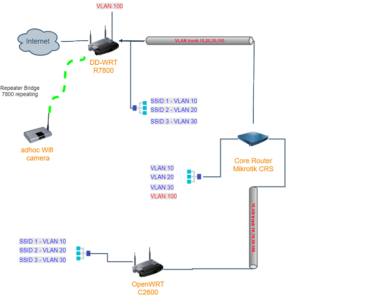

Where do I look? Interface is on a VLAN, link is connected to an untagged port.

Expected setup is for the switch to hand out IPs on all internal VLANs (not VL10) to local clients and clients on switches at the end of any of the trunks; and to ask for an address on the VL10 (WAN interface). All of the trunks carry all of the VLANs. I’ve posted an image below for reference. I’m still setting up the APs also.
